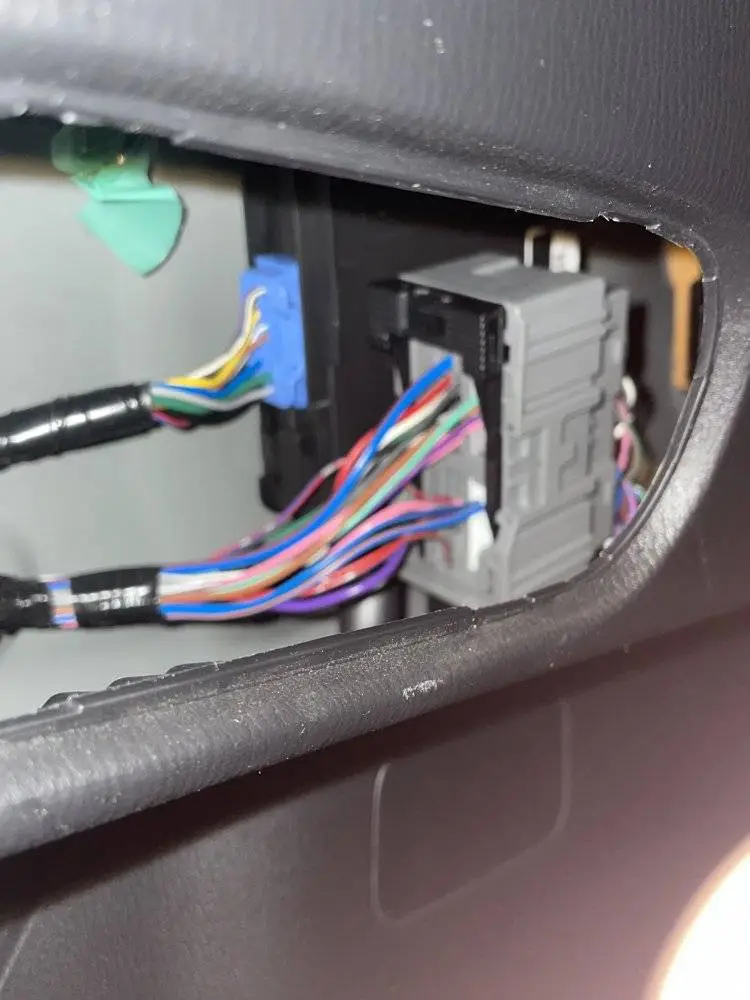

The turn signals like they normally would. I think I may have narrowed it down to the BCM. It was really quiet and when I pressed the lock button on the door I could hear a faint click. I traced it back to the area where the BCM is. I unplugged one wire and the locks didn’t work at all. Plugged it back and the unlock was working again as before. Not sure the options on this. Looks easy to replace but the internet seems split over having to take it to dealer afterwards. The large black box is the rear BCM located above fuel door more or less.

I can manually lock the doors. It has to be the rear BCM. It’s the only thing that makes sense at this point. The BCM controls the auto locks among other things.
You are probably right about the BCM.
I can't hear the click in the rear because the locks make too much noise.
If you can hear it the signal gets that far. Maybe check some schematics to see where the signal goes next?

Thanks for everyone’s input. As far as I can tell it was the rear Body Control Module. I found one on eBay from another 2016 CX 5 for $55 and swapped it in today. Locks are now functioning and so far everything else is as well.
Thanks for the update. RBCM usually got damaged when people are not careful replacing the trunk light with LED but the RBCM doesn’t have fuse protection. Mazda revised the circuitry and put in fuse protection to RBCM since 2016 CX-5. Hence it’s rare to see any reports on damaged RBCM on a 2016 CX-5. Of course your problem is different from those from 2015 CX-5 and prior.
