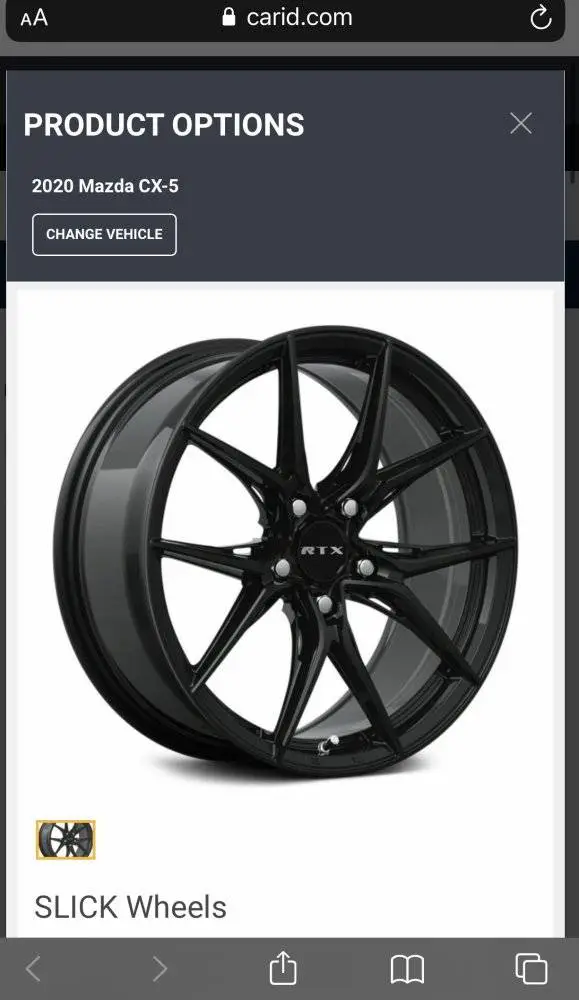

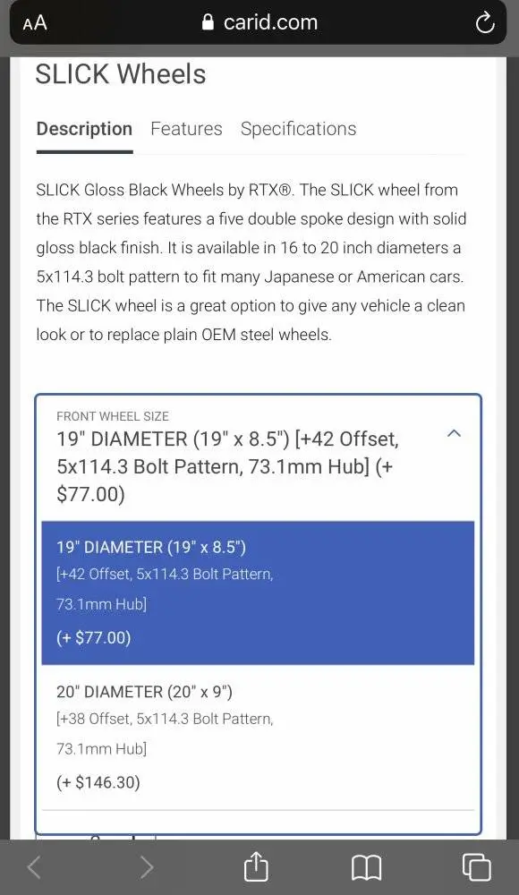

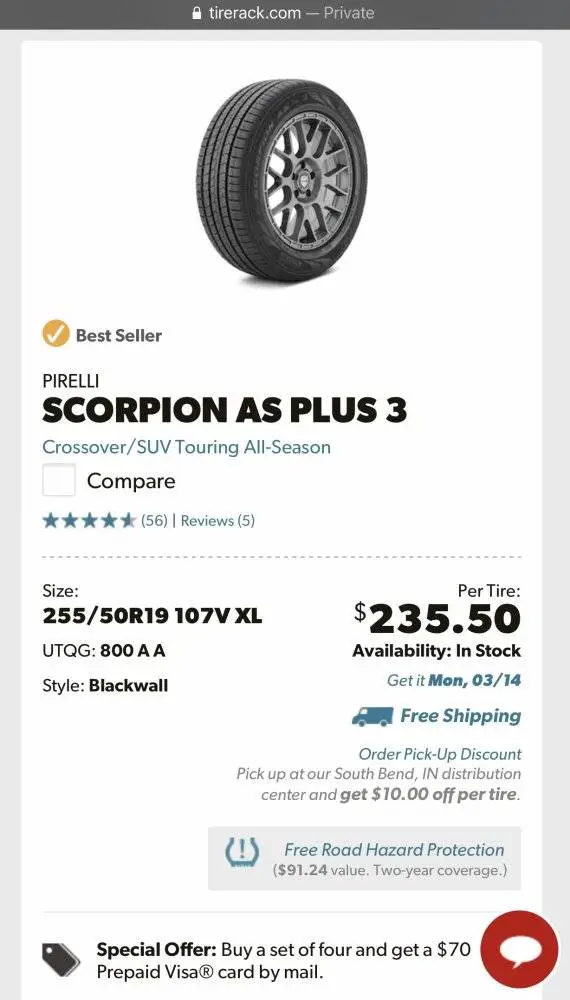

2017~2024 Wheels 19” x 8.5 +42 offset 5x114.3 bolt pattern, Tires 255/50r19...Will it work?
Afternoon,
Before buying I just wanted to confirm if I did my research right.
This is for a Mazda CX-5 2020 GT
Rims 19inch with 8.5 depth and +42 offset
Bolt pattern 5x114.3
Tire I want as flush as I can with the fenders
255/50r19
Please let me know if you have any suggestions.
Thanks
Thinking of getting these rims
I like the look and spec seems fine
With these tires
Wheel will fit with no issue…. I’d stick with a 234/245 tire on a 8.5 though.. a 255 might get to lose to your strut/spring
