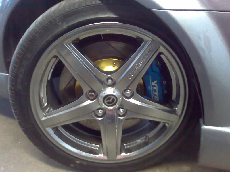

Here are pics of my car with 1/2 spacers...I also have different wheels then stock :)
