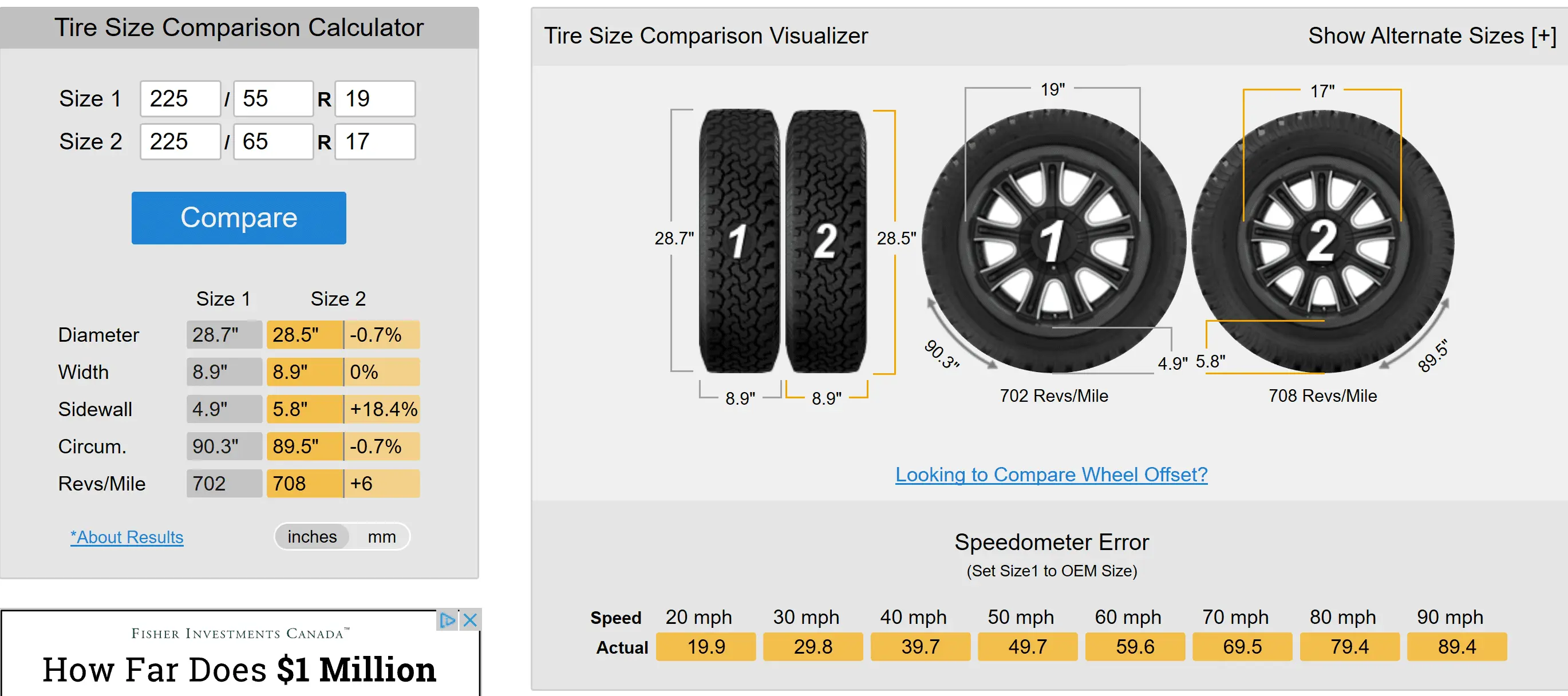

Try using this site for your calculations:
Your wheel diameter may be a bit tad off with the 2 sizes based on:
I have used both calculators - and they are great for determining tire size based on rim size. But the real concern relates to backspacing and the room around brake and suspension components. The increased offset and the wider wheel put things 11.4 mm (about 1/2 inch) closer to those components. I'll need to check my current spacing to assure that I have that room - but hearing from folks like StickyGreen and real-life experience is gold! Thanks for the replies so far.

The first website I posted allows calculations for fender/wheel well/suspension. Further down towards the bottom chart it also shows the optimal rim width size. It does also allow you to play with the offset values to see what the difference is based on current and new setup.
