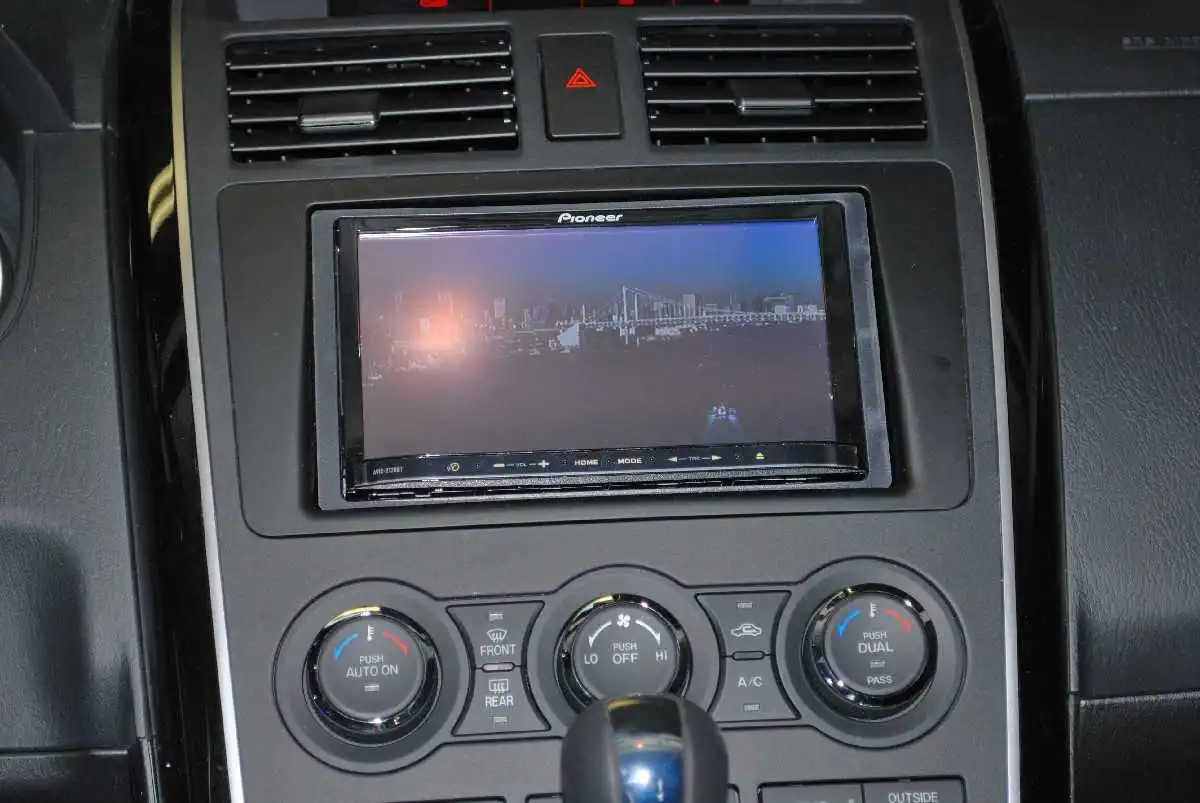

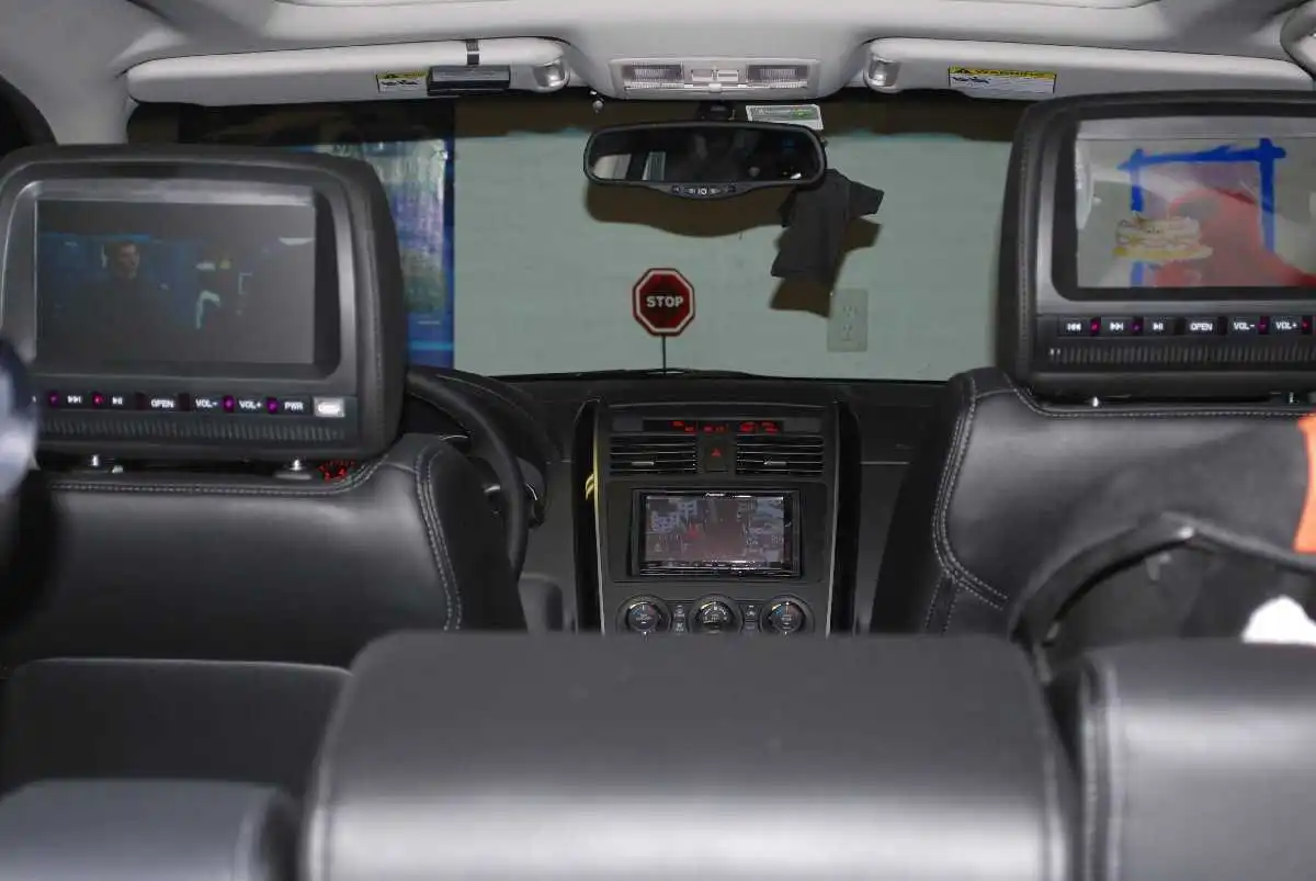

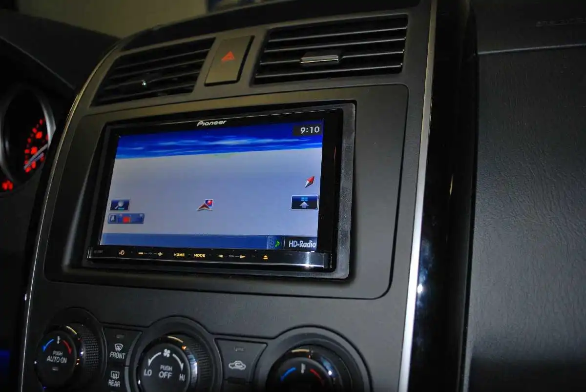

I've installed pioneer z110bt on my cx-9, everything works great except the navigation which sometimes doesn't show the position correctly, that can be due to bad gps signal, later I'm going to change the position of gps antenna and see if it works. From the reviews I read Kenwood has the best gps software, but in terms of other features like ipod, bluetooth, and amplifier I believe pioneer will do better. From all the nav units I've seen online I would either go with the pioneer z110bt-130bt or Kenwood DNX9140. If you're lucky you can buy a pioneer unit from eBay for 600-700 brand new
