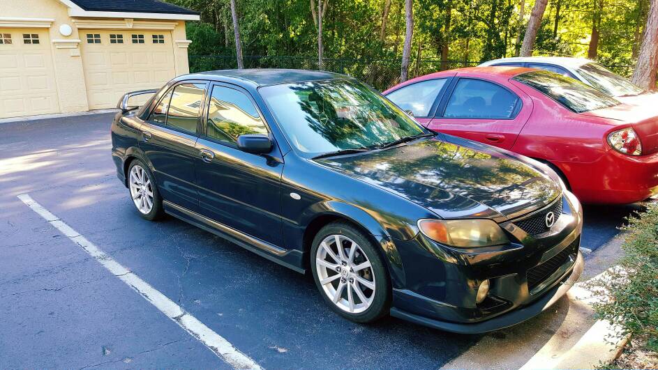

My Mazdaspeed has been really happy this morning with temperatures being 65 degrees Fahrenheit
