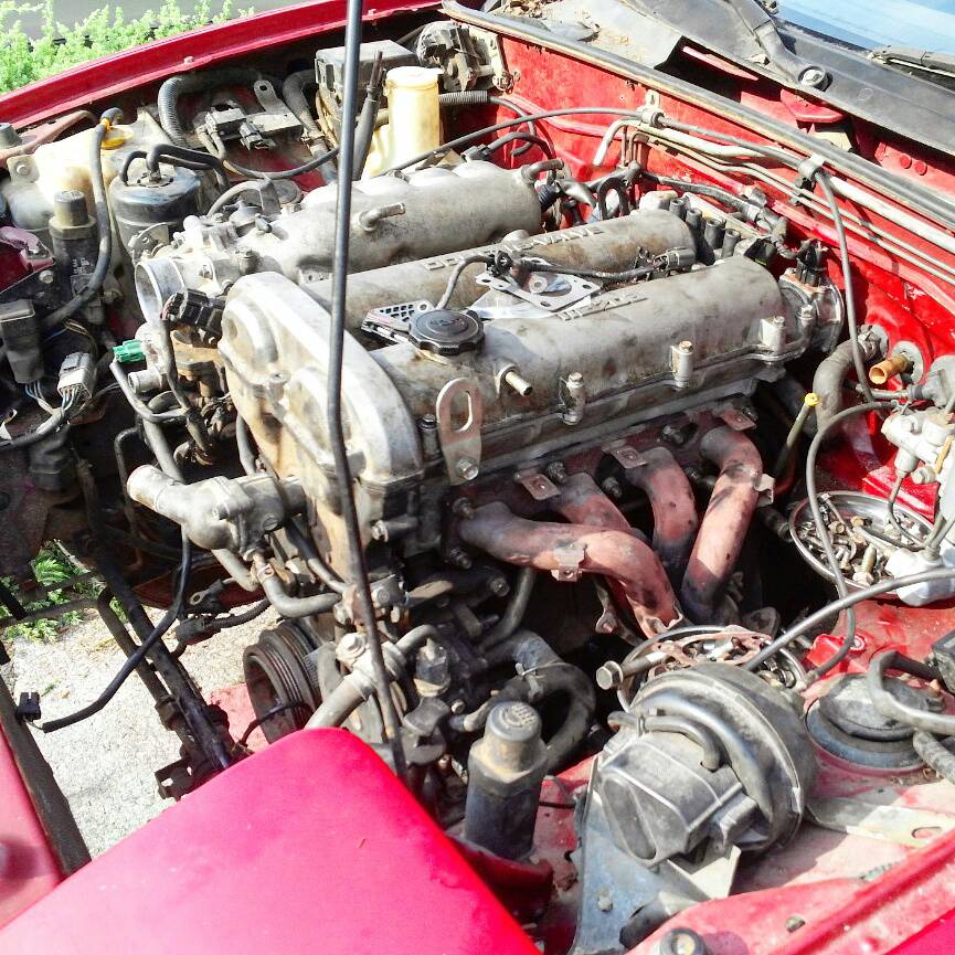

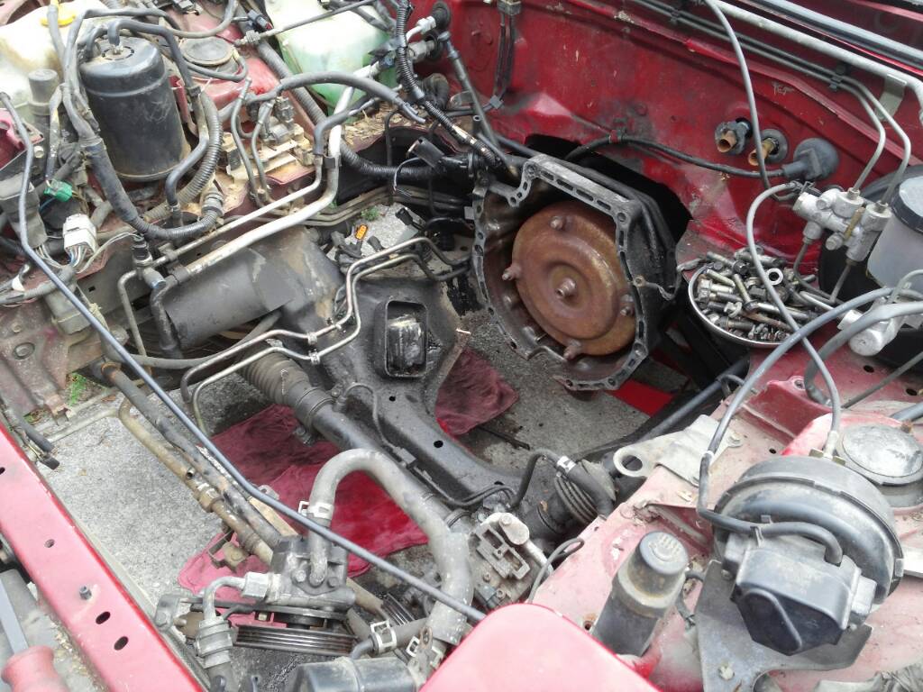

Further disassembled the engine in preparation for removal- removed accessories, starter, a couple of bellhousing bolts and radiator. Basically, at this point, it's the remaining bellhousing bolts, torque converter bolts and engine mounts keeping it in place.
I plan on removing the engine, from the top, without the transmission mated to it- any tips or suggestions? I think the FSM suggests removal by dropping the cradle just as it did with my RX8, but I separated the two and swung it right out and back in without issue in five hours (R&R was close to 9 if I remember correctly), and I see no reason this cannot be done with the NA. Furthermore, this is being done in my driveway and not my shop. Thanks in advance!
For a driveway job (or really, any non-lift type job), it can definitely come out the top. Having a load-leveler is key, however. You'll lift a little, bring it forward a little, bring the angle up a little, lift a little, bring it forw....you get the idea.
Oh, remove the hood too. I have no idea if it COULD be done with the hood in place, but I doubt it, and I wouldn't want to try lol
Having an owned an RX8 for a few years, working on it and my friends MSM, they're incredibly similar, almost identical, in layout and design. I was going to approach it just as I had on those vehicles. Thanks!

I have always found it easiest to pull the transmission with the engine... It was easier to deal with trans fluid and two PPF bolts than re-aligning the engine-clutch to the transmission IMO.
Like AMaff said, take the hood off, take the radiator out, get an engine leveler, and the engine and transmission can come right out the top!
Starting to tilt and slide:
Most of the way out:
Splitting/attaching the transmission outside of the car:
I've even pulled the engine with the entire intake and exhaust manifolds and accessories still attached! It is super easy.
So much this. If I'm just changing a clutch, I'm obviously not going to pull the engine, but if the engine has to come out? Might as well pull the trans too and get them lined up outside the car.

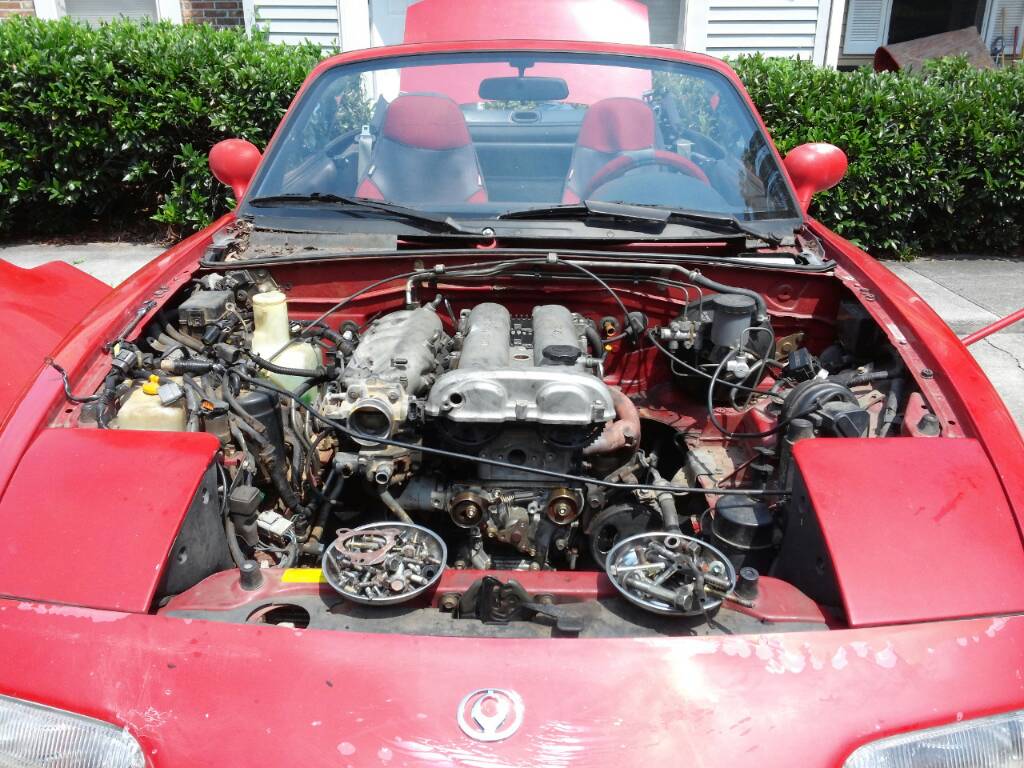

I wanted to make it this year in the $50 Miata seeing as how I'm only 30 minutes away, but wasn't able to do so. Instead, I spent the day removing and installing the BP4W. I shouldn't have more than a couple of hours remaining.
I spent, like, twenty minutes searching for my CKP sensor connector, the chassis side... Couldn't find it... Did a little research, and, apparently I just wasn't paying attention to the fact the CKP sensor was connected at all because it doesn't have one as it's a 1995. VIN on the engine that was removed didn't match and was a remanufactured unit as indicated by the heat tab affixed to the block. Want to check that VIN and see what year engine that was. Going to remove the CKP sensor. Unless I'm completely wrong and am still missing it somehow.
Are you talking about the Crank (or in your case, cam) Position Sensor? Not sure what you mean by "chassis side," but the sensor itself is visible in the last picture, on the back of the head, next to your coil packs, and appears to be plugged in. Kinda confused as to what exactly you're looking for.
I saw that bowl of bolts and cringed. If it was my neurotic and insecure self tackling this type of job, I'd have all of them laid out and marked with where I removed them from to ensure (I'd still probably screw it up) I put them back in the right place. lol
Understandably so, but that's a magnetic tray and designed for just this purpose. The majority of the bolts shown are from the engine removal as it was partially disassembled before removal. Engine assembly, for the most part, took place on my back patio and indoors. That's not to say I'm not using various bolts from disassembled to finish up reassembly. Plus, you put the bolts in as they came out, they more or less stack. A quick visual of a bolt to go beyond thread an pitch, gives big indicators of its placement- rust, grease, clean, shouldered or not, flanged or not, finish and, of course, length. While many bolts may fit, having an eye to spot the correct bolt is key. Having owned and worked on my own vehicles being Mazda for the last decade, that also helps. Really, it's just about common sense.
I figured the tray was magnetic. Everything you said makes perfect sense and with the experience comes courage, in my case. Anytime I attempt something new, I over analyze and think of all the things that could go wrong vs. being confident in my abilities. I'll admit, it's actually stopped me from attempting some jobs where I've ended up paying someone to do it.
