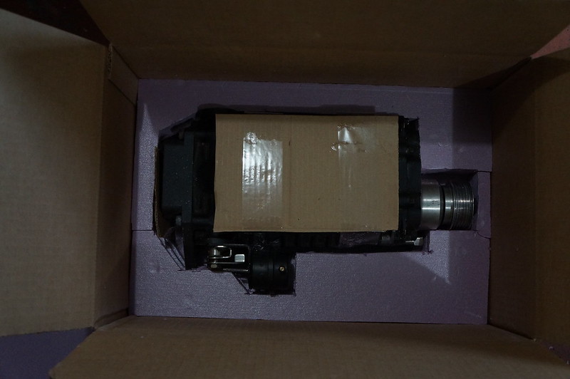

Finally received the double-wall boxes I ordered yesterday, but too late to get it packed up and shipped. Did that first thing this morning. I cut the styrofoam to fit and layered it in the box to give a nice, solid holder all the way around the 'charger:

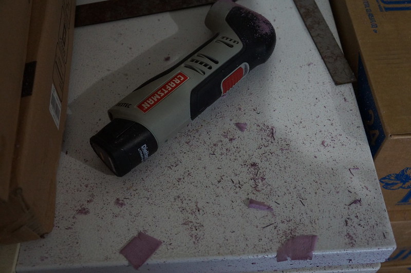

Cutting it was messy but made a lot easier using my weapon of choice:
It is due to arrive at the rebuilder's on Monday, I'm hoping they don't have too much of a backlog and will be able to tear into it right away.

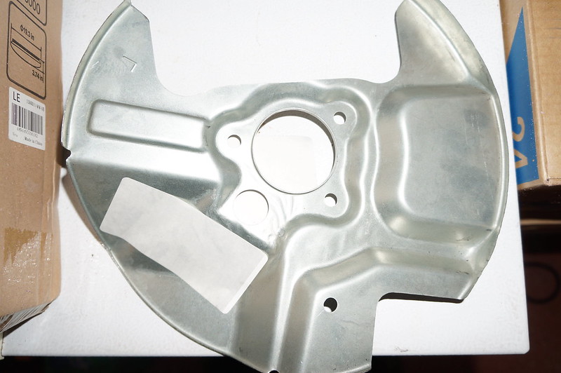

I bought a new driver's side brake shield, I had to cut the original a little bit for clearance when I tried to fit the BBK I had and it bothers me despite not being visible. Also, today was a good day:

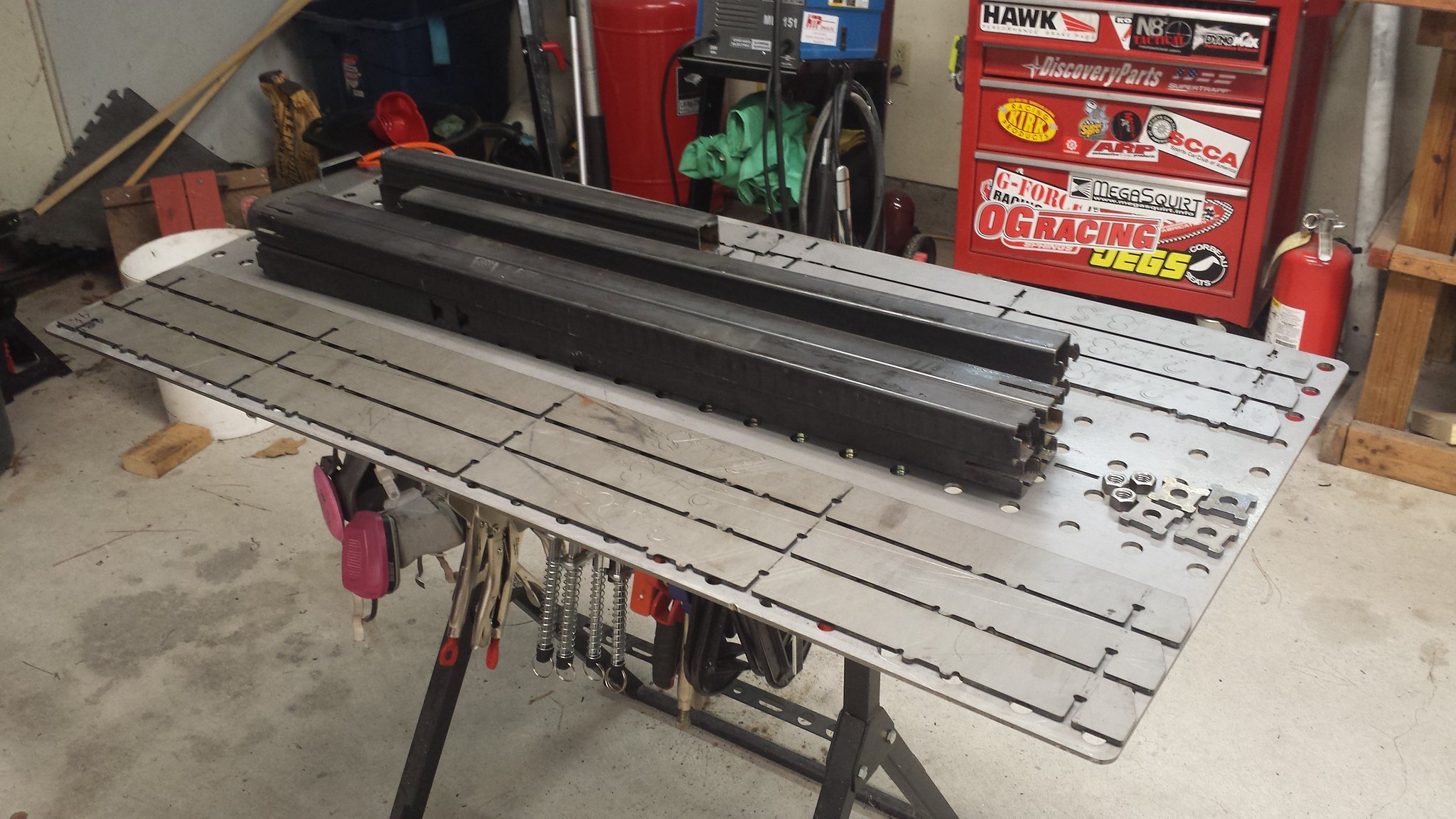

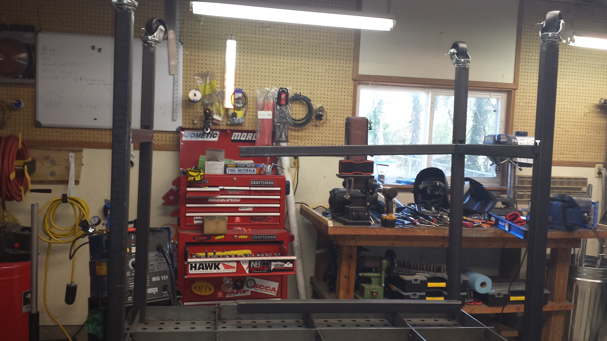

So close, and yet about 10" too far (rlaugh)
It appears they shipped the long-side stringers for a shorter table. I'm sure they'll make it right, but it's fairly annoying in the interim.
What, no jury-rigging?
If I wasn't fairly confident that they'd make it right in relatively short order, I'd have totally done that. Some 2 1/4" square tube would slide right over that, cut the supplied stringers in half, then sleeve them. But I don't think that'll be necessary. I imagine that this will all be sorted out with a phone call Monday morning.
So far so good. Tab and Slot is sending out the right stringers. At the same time I ordered another small "fab square" from them, and they threw in a discount on the part for my trouble + free shipping, tossing it in the box w/ the stringers. Gotta love good customer service.

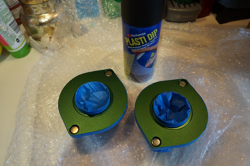

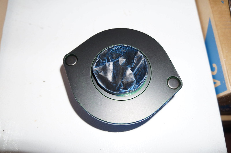

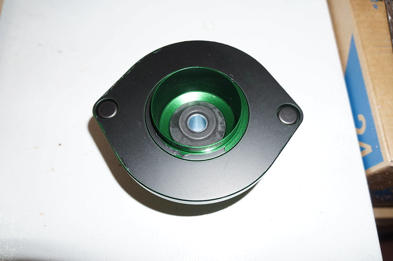

Since I have some time on my hands now while waiting on the supercharger to get rebuilt, I decided I would try putting the Feal top hats on again but not use the rubber cushion on the top. I don't want the spring to contact the top hat with nothing between so I picked up everyone's favorite rubberized coating:
A little cleaning with denatured alcohol, taping and spraying later, I had this:
Peeling the tape off removed a little of the coating as you can see but nothing to worry about.

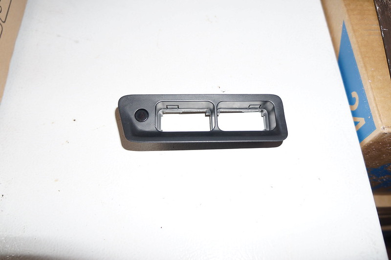

I also received the following today:
The second picture is of a switch housing that replaces the air bag switch in US cars. As some point I will likely install seat heaters so this will give me a place for the switches.

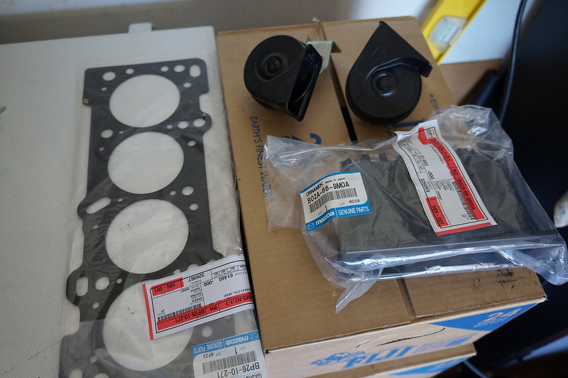

Today was a good day. I picked up or received what's in the picture:
Horns are actual Fiamms from '90's Mazdas, they are brand new from the same place I got my ashtray from. They are a little smaller than the horns I currently have, and since they are actual Mazda parts that's a plus. The cubby and head gasket I got from the local dealer. After thinking about things a little more, I decided now would be a good time to install the ported/polished head I have along with the JDM intake cam. The cubby is for another little project I am contemplating.

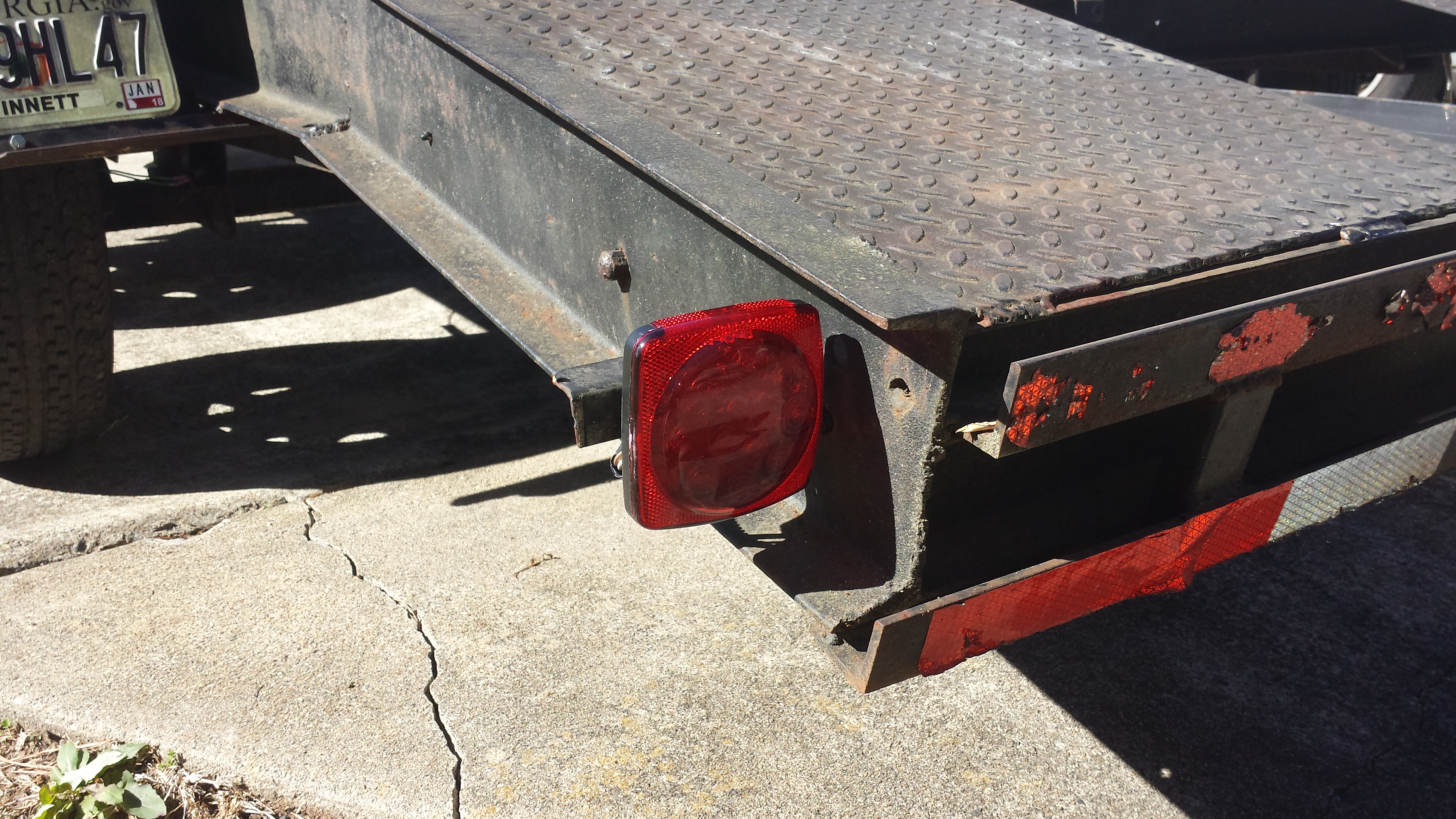

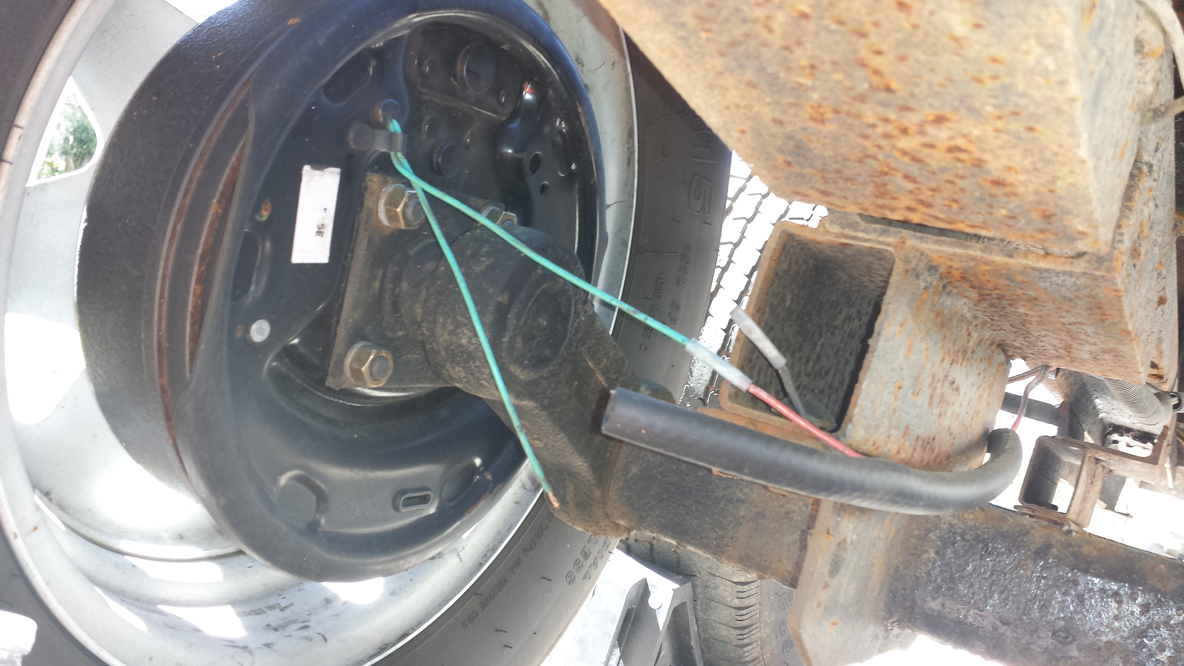

I figured out why the trailer brakes have had some intermittent weirdness including pulling to one side.
Gotta love a "professional" install. I didn't have time so I took it to a place I trusted. That status has been downgraded. Way too much tension on that cable and it was routed stupidly, so I cut it all out and re-did it properly. It would work better if the green thing were connected to the black thing...
Also replaced the dodgy incandescent tail lights (that on occasion needed a kick to get the driver's side one to work properly...probably had a short internally) with some LEDs, along with a couple of the side markers which had blown, also with LEDs. She's been neglected of late, I guess, is what I'm saying.
You cant blame us Mike. You have spoiled us with all these posted pics. Lol. Nice score there and the horns are awesome. Never would have guessed they were OEM. As for the large item, whats another day? Lol. 😝
