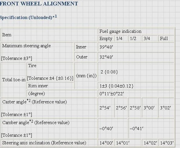

Y yukonm Member Feb 25, 2005 #1 Anybody know what the factory Mazda3 5-door alignment specs are? How much negative camber is possible from the stock front suspension?
S ssinstaller Member : 2006 MazdaSpeed 6 Feb 26, 2005 #2 here: Attachments front.jpg 65.1 KB · Views: 917 rear.jpg 54.7 KB · Views: 1,005
G goldwing2000 Turd in the punch bowl : 2004 Mazda3s Hatch; 269,000 miles Feb 26, 2005 #3 Just so you know, caster and camber are not adjustable with the factory suspension (front or rear).
