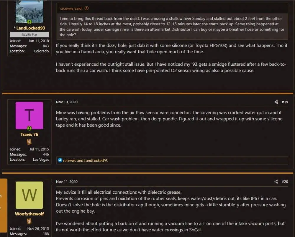

Since you seem to be an "off-roader" type, here is a snapshot and from a forum where some have issues similar to yours just a bit "different" vehicles...
Car Wash Stalling
