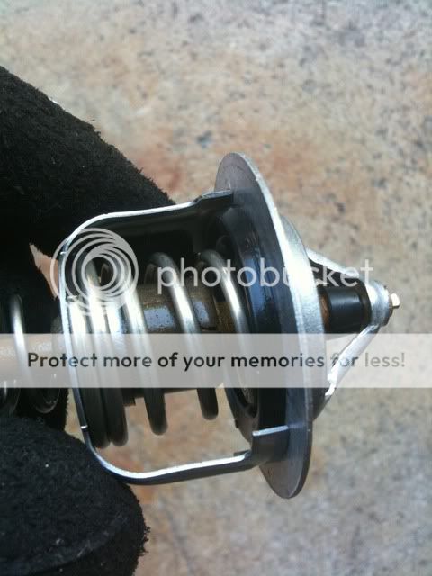

This is a picture of Hatchkittens bad thermostat:
I could see that crack hanging up in an intermittent kind of way.

That is exactly what the thermostat looks like that I replaced a year and a half ago (I still have it), I mean the same cracks. I had replaced it with a Murray Ultra.

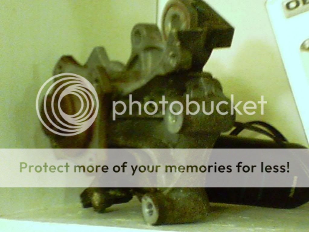

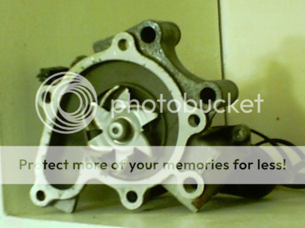

A couple of pics of my old one:
Those things could very well be like our coils fussy and hard to diagnose.
