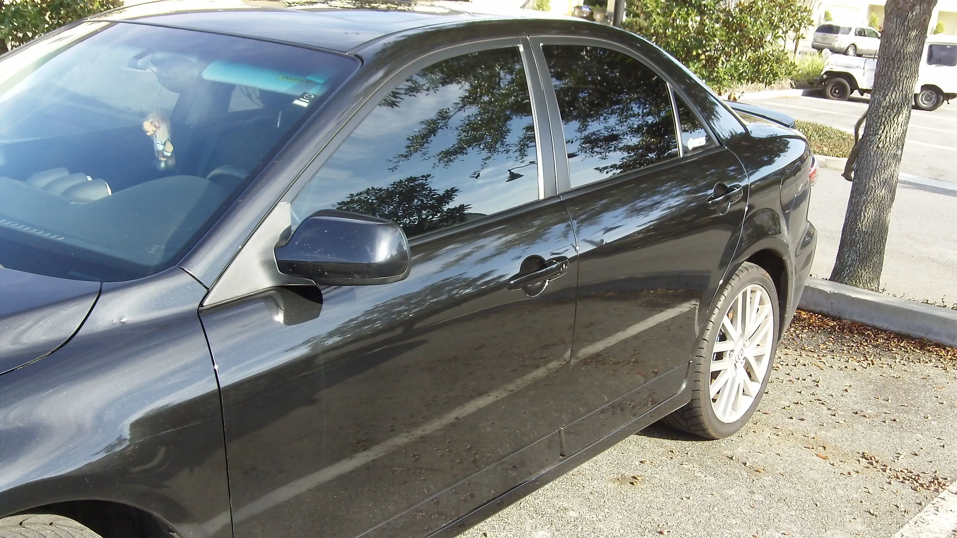

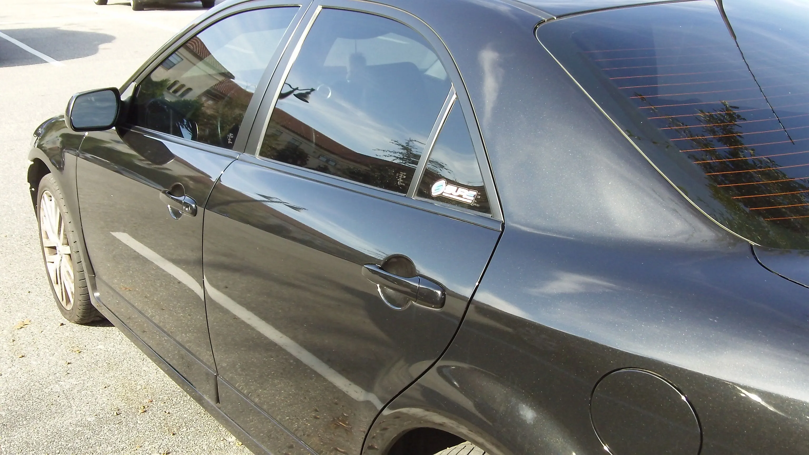

some pics. Don't have a camera so these pocket cam's will have to do for now.

I'm thinking you had pics with the pinstripes! Remember, there are those of us....especially with the beautiful BCM hue, that weren't cursed with it.
