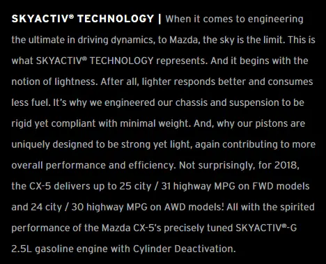

From the U.S. 2018 brochure...View attachment 308208
You assumed I have that model MAZDA I don't. ;) Mine does not have cylinder deactivation and I very glad. Also, there is a production date when they actually made them available. The ad does not explain that small detail? But they never do. In fact when you buy parts aside form the VIN your production date is the most important information to have available to get correct part the first time. The production date is located driver side door jam sticker.
Upvote 0
Well, this is the CX-5 forum, you didn't state otherwise, and you made a sweeping statement about 2018 Mazdas not having cyl deactivation.
