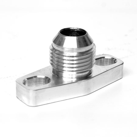

-10AN oil return flange
http://www.atpturbo.com/mm5/merchant.mvc?Screen=PROD&Store_Code=TP&Product_Code=ATP-FLA-019&Category_Code=

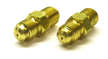

-4AN oil feed fittng with restrictor (or should i use -3AN ?)
http://www.atpturbo.com/mm5/merchant.mvc?Screen=PROD&Store_Code=tp&Product_Code=ATP-OIL-021&Category_Code=BCS
http://www.atpturbo.com/mm5/merchant.mvc?Screen=PROD&Store_Code=tp&Product_Code=ATP-OIL-036&Category_Code=BCS

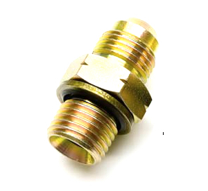

for the coolant i found this 14mm banjo to -6AN male end
http://www.atpturbo.com/mm5/merchant.mvc?Screen=PROD&Store_Code=tp&Product_Code=ATP-FTG-053&Category_Code=GRT
or should i use this and skip the banjo bolt
http://www.atpturbo.com/mm5/merchant.mvc?Screen=PROD&Store_Code=tp&Product_Code=ATP-FTG-012&Category_Code=

Good luck on the -10 drain. There's so little room down there that I couldn't make it happen, atleast that was with fittings on the flange and the windage tray. If you can go from fitting to just hose on the oem drain tube, it may work.
Banjos on the water lines will make it easier to route the hoses.
In my opinion, the oem lines and tubes are the best use of space and make the best routing. If you're looking for sprucing up your engine bay, go with braided but make sure to plan your routing carefully as they don't turn corners as nicely as the oem parts.
