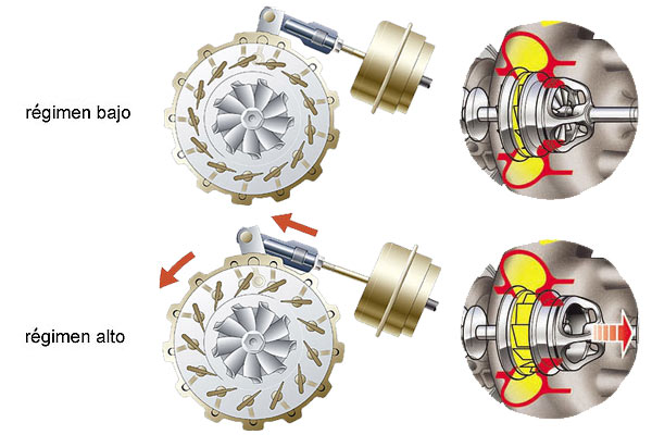

I have never heard of this before?
a variable turbo refers to its compressor, where it self adjusts for different needs...
the compressor is responsible for 'boosting' the intake charge over ambient air pressure...the compressor is attached to the turbine on the 'hot side', which is spun by the exhaust stream from the cylinder head...
the trickier thing with turbo's, most often overlooked in enthusiast minds...is that boost actually has little to do with the power being made from a turbo...its all about the additional flow...boost pressure only gives an indication of engine efficiency, which is very useful for tuning...but 10psi of boost from different turbo's result in very different engine outputs...
so where a standard turbo setup can have parts that adjust this boost pressure, by either changing it at different rpm, or bleeding it off, etc...a variable turbo is able to change its flow characteristics...which is a much more useful way of controlling the way the engine and turbo work together...
Porsche 911 Turbo's have used these types for years...the veins or 'fins' on the compressor change length and geometry on the turbo...so at low rpm it will spin up like a small turbo, but also flowing air like a small turbo...giving a gradual rise to engine output; as apposed to the common 'on/off' many big turbo cars have...as engine rpm and turbo speed climb, the fins extend out more, moving even more air...engine output skyrockets, but there is no conceivable lag or delay as the turbo was already spinning...
its a better solution to the 90's era sequential turbo design...where a car (such as an FD RX7) had both a big and small turbo...the small turbo ran for low rpm, and eventually the bigger turbo was then plumbed in...on paper that sounds great, but in practice it was notoriously unreliable and unpredictable...
