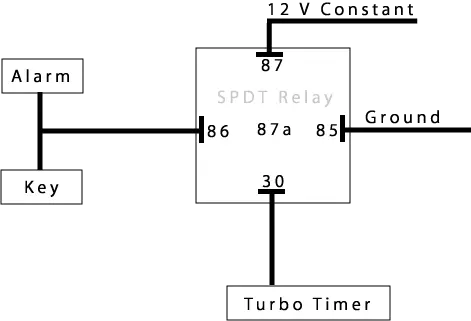

from doing some research on here and talking to a couple of buddies, i have come up with a diagram of how i will try to wire up my relay for my alarm and turbo timer to work successfully. i just need some more feedback and any helpful suggestions before i continue.
o yea, i forgot to mention. the wire that comes from the turbo timer into the relay is the ignition wire and the wire that comes from the alarm into the relay is also the ignition wire. hope i'm not to confusing. the only question is whether or not im right????
