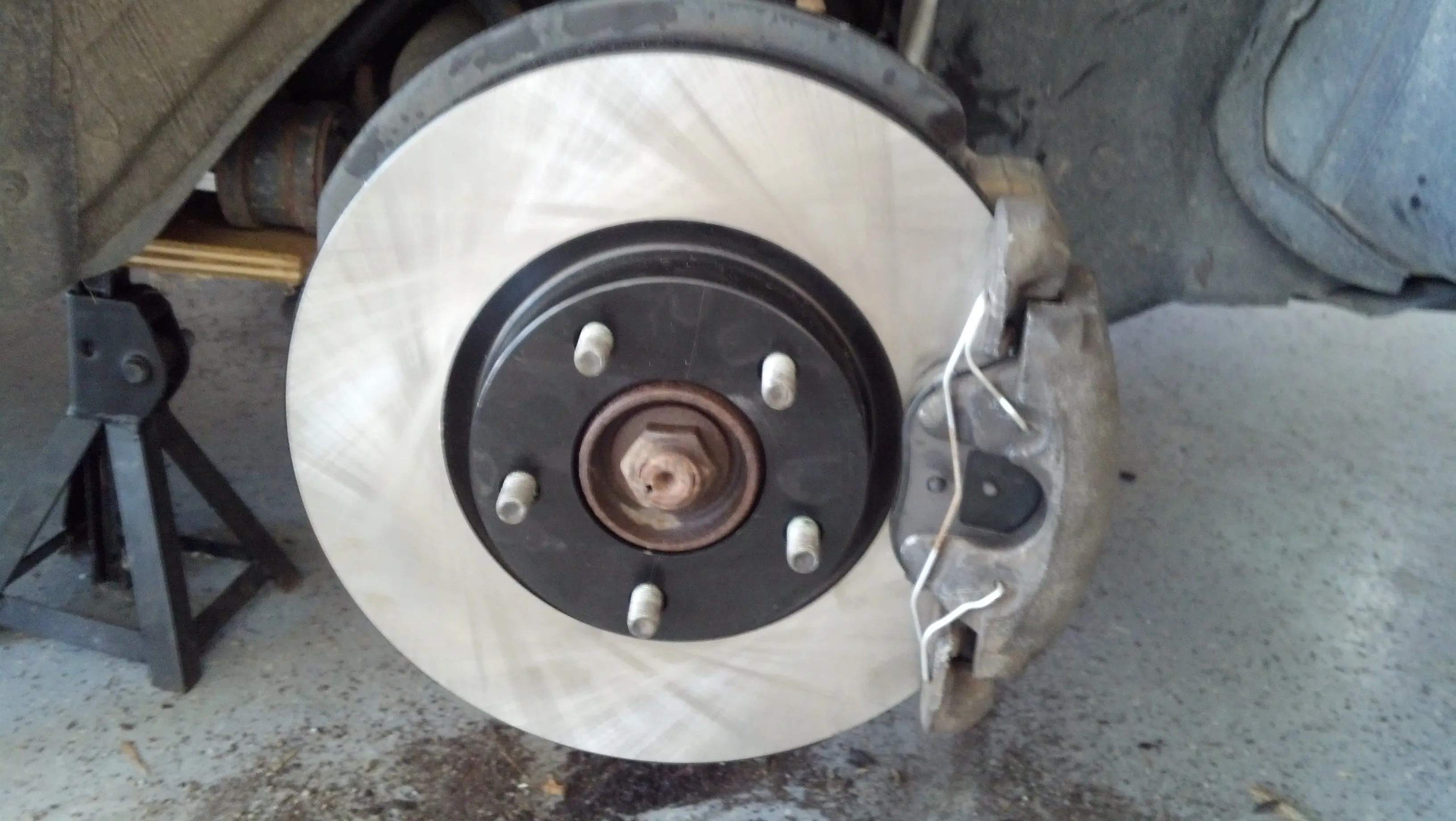

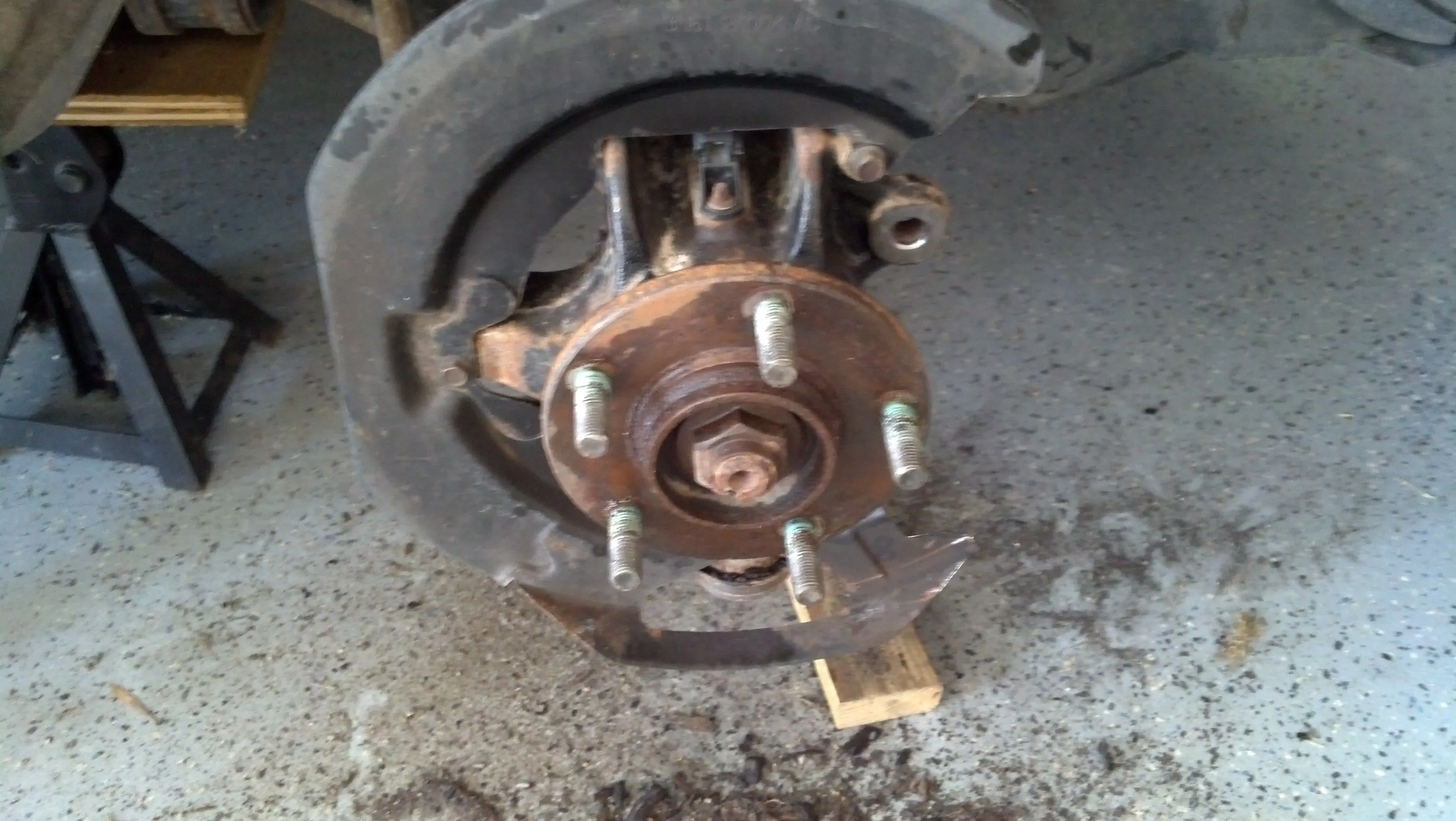

About a month ago I did a complete brake job (rotors and pads) on all 4 corners of our 2008 Mazda5 with 62K miles. I was replacing the original factory hardware. I too had a helluva time getting the front rotors off and I used plenty of penetrating oil and a 4lb. hammer. Eventually, the disc portion of the rotor completely broke off the central hub-mount portion of the rotor and I could pry it off completely with a claw hammer. I've included a couple photos below. Interestingly, the rear rotors came off surprisingly easy after the ordeal up front. Before I reinstalled the new rotors on the wheel hubs I used some sandpaper on the wheel hub to remove any rust or corrosion and I used my finger to put a light coat of high-temp anti-seize around the outside perimeter of the wheel hubs where they contact the rotor itself. I'm not planning on having to replace brakes again on this car but whoever comes after me ought to have an easier time of it.
