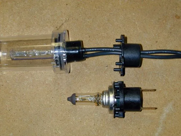

Are they HID Kits?? or Hyper white BULBS?? If it's the real HID, then you need a spacer. but if's just a bulb, then you need to remove that black adaptor, and plug it on the new bulb.
Here's a pics . top is the HID, bottom is H7 Bulbs
I actually just figured out what was up. The stock bulb was in an adapter. Had to take that bulb out and put in the new one.

Ok, so I just bought the DDM 55W kit and discovered that I need the spacers pictured in CTpro5's post. Where can I get some?? The kit just has plain bulbs and when I called DDM tech support, they told me to "look on the Mazda forums". Grrr... (pissed)
Just take your original spacers that are on the H7 Bulbs, and modify it to fit the HID Bulb. Or you can always put the HID bulb in without any spacers. Just take tha metal springs that hold the bulb in place and bend them to fit the new bulb(This is easier if you actually take the whole light assembly off the car)
Modifying the clips is a bad idea because then you can't use the weather seal on the back of the headlight and if you break a clip, they're impossible to replace (ask me how I know).
