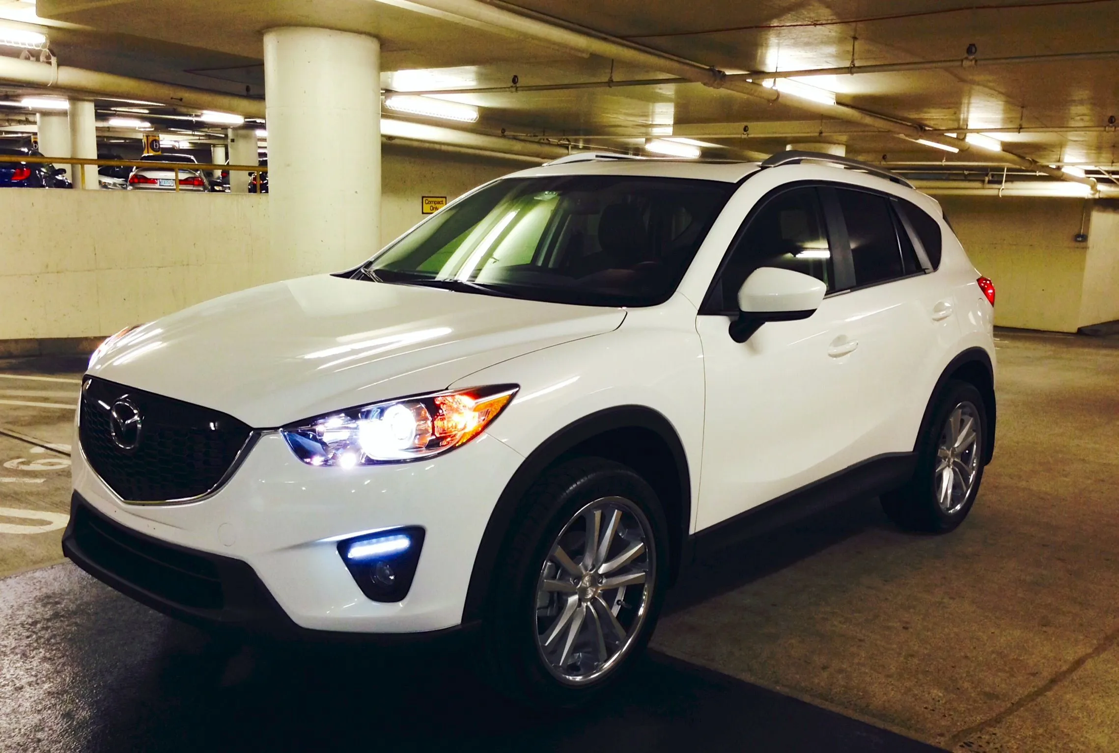

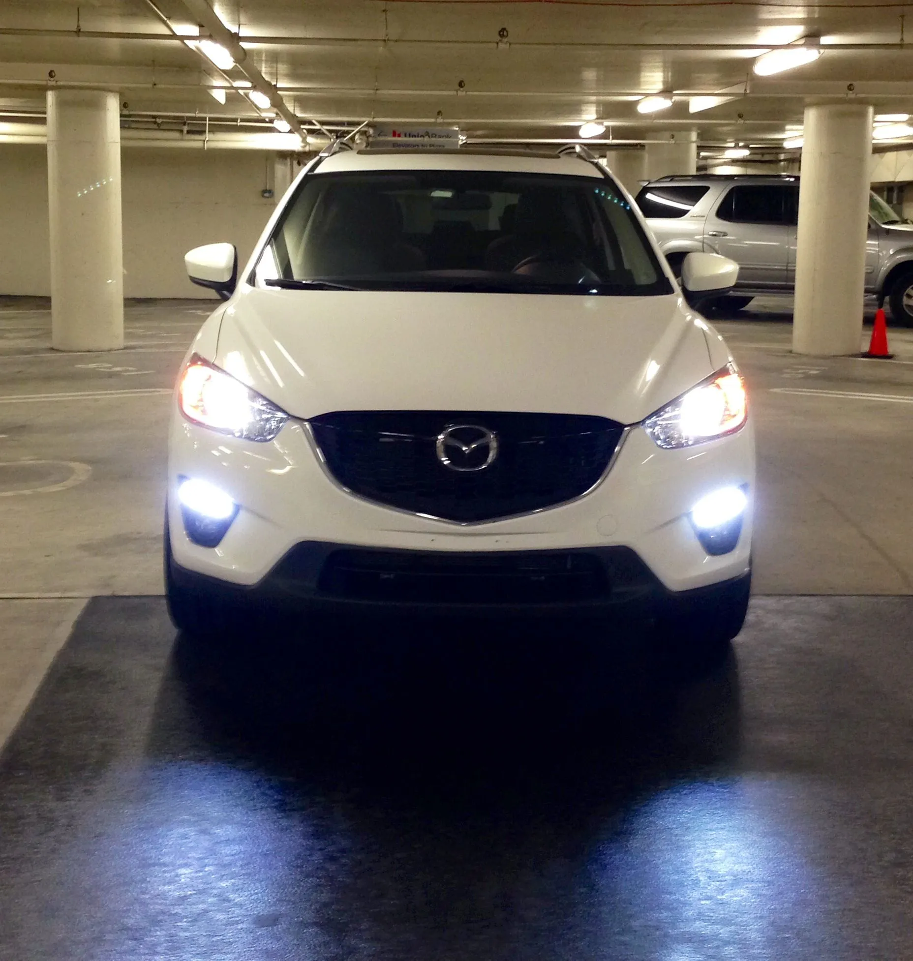

People here may tell you not to get the aftermarket plug and play kits. I got one on my wife's CX-5 and love it. I also had the same kit installed in my wife's Mazda #3. Never had issues, or people flashing their high beams at us. I would NEVER get them on a car with reflectors instead of projectors, since then it scatters everywhere and the light output is probably s#it.
Below pics: The first two are with the left light being stock halogen and the right replaced with HID. The last one is both replaced with HID.
There is a little bit of scatter, but as I said I have never had anyone flash me due to it being irritating to other drivers. I got mine from DDM tuning. This is the 2nd kit I got from them and my buddies also got a couple, and so far, we have not had any issues.
