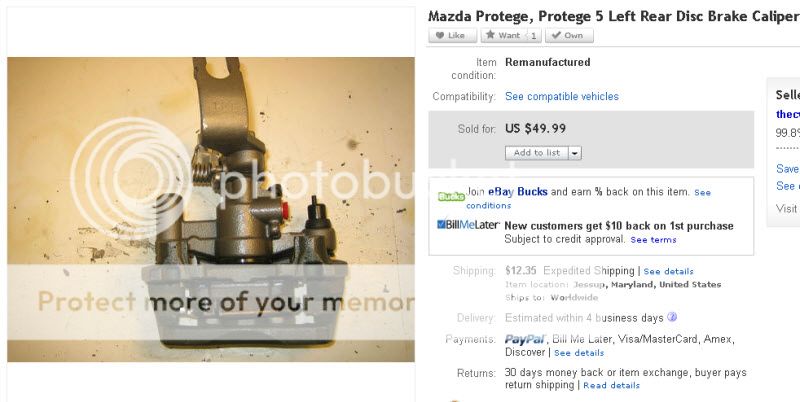

This was it, the drivers side caliper seal where the parking brake pulls. When I first looked the car was wet (typical Oregon Weather) so I could not tell for sure last week. This morning I put it up on stands and crawled around on my back looking specifically at all connections and this time the underside was dry except for drivers side back caliper. Had my lovely assistant (wife) pump the brake pedal hard and it just pours from the seal. Every time the E-brake is pulled too, drip drip drip. So now to replace the back caliper. Here are a couple of pictures.
Good catch man. Caliper is an easy Remove & Replace. Clean those brake pads & Rotors real good w/ brake-clean you don't want brake fade do to contaminated brake pads.
