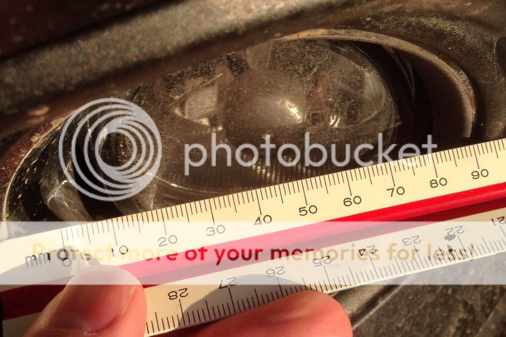

Excuse the dirtiness/lack of accuracy thanks to the angle of the thing:
Looks to be about 85mm ID... However, another user has successfully installed the 90mm Hella option with some light Dremel work to the chrome-plastic trim. See this thread: http://www.mazdas247.com/forum/show...ID-projector-fog-lights-(night-time-pictures)
