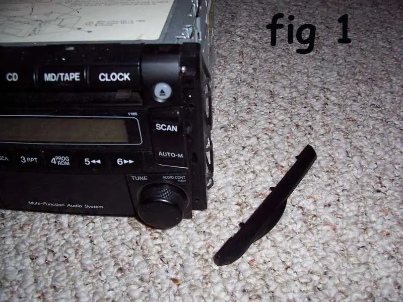

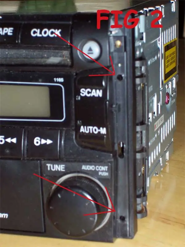

ok here are some pics.
step 1. remove plastic cover on stereo (fig. 2 just pops off with screwdriver)
step 2. (you need the 2 metal u shaped tools) insert into holes (red arrows fig. 2)
step 3. pull away from center of stereo (left push towards steering wheel, right push towards glove box) stereo should release now just pull out and remove plugs
