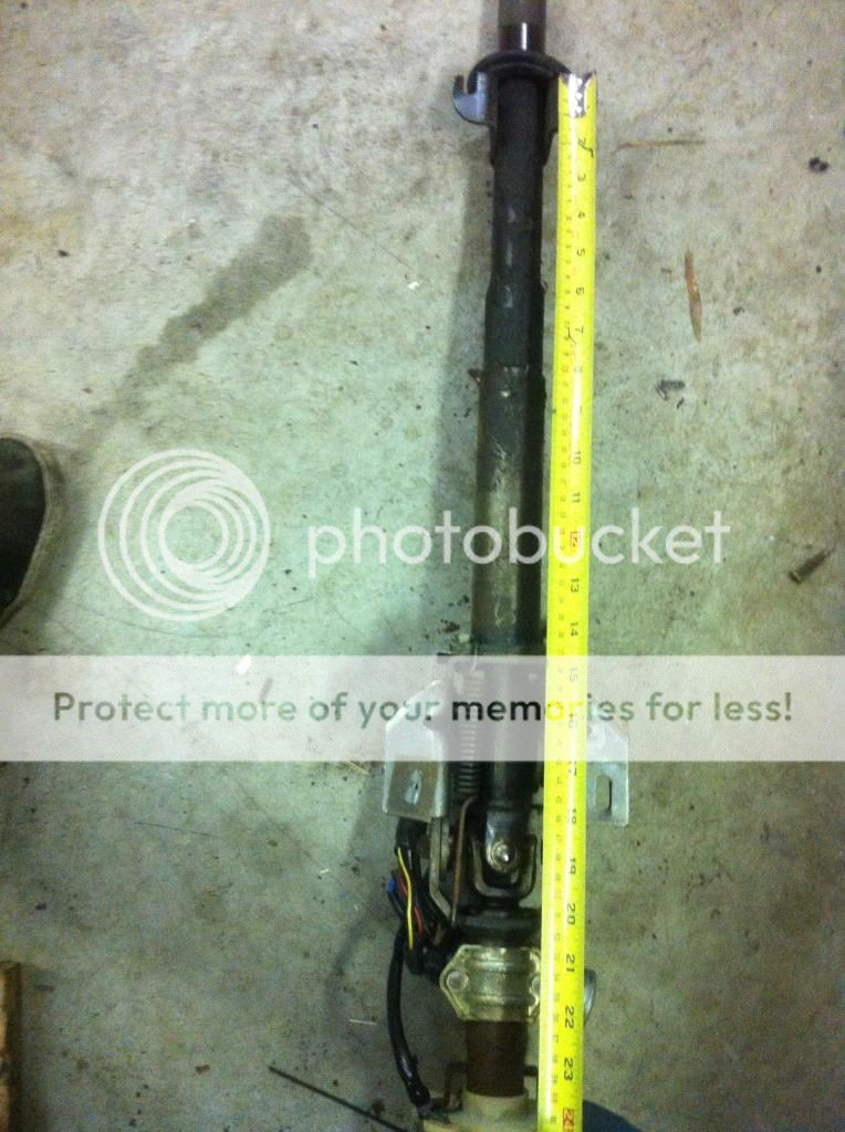

If you could measure the FC rack you have from middle of U-joint welded to the shaft to the end of the column at the upper bearing support that would be helpful.
Thanks,
Alright heres what I got from your description:
19 inches from the support to the middle of Ujoint
And just in case, 24 inches from tip of shaft to middle of U joint
That seems to be about the lenght I am looking for at the middle of a u-joint. What's the deal with a u-joint near the top of the shaft, is that how the tilt was built into the column?

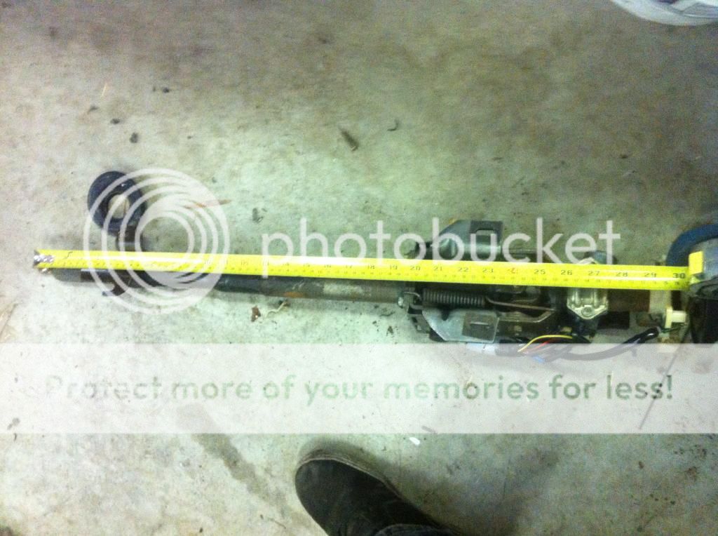

Is the overall lenght 30" or is a bit long at the threads for the steering wheel? Thanks, those pictures help a lot.
Uh roughly 32" long, I have a Momo hub on it and am not sure much that takes off.
And ya that top U joint is for tilt. I have to find a way to get rid of as much weight from it as possible
