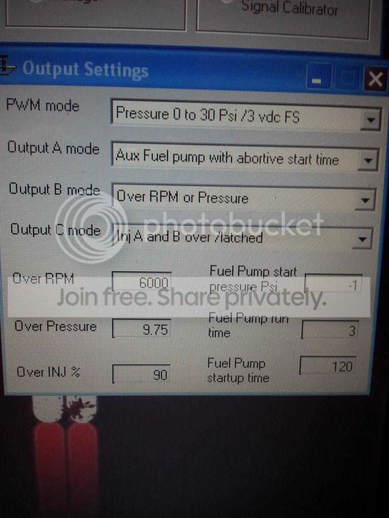

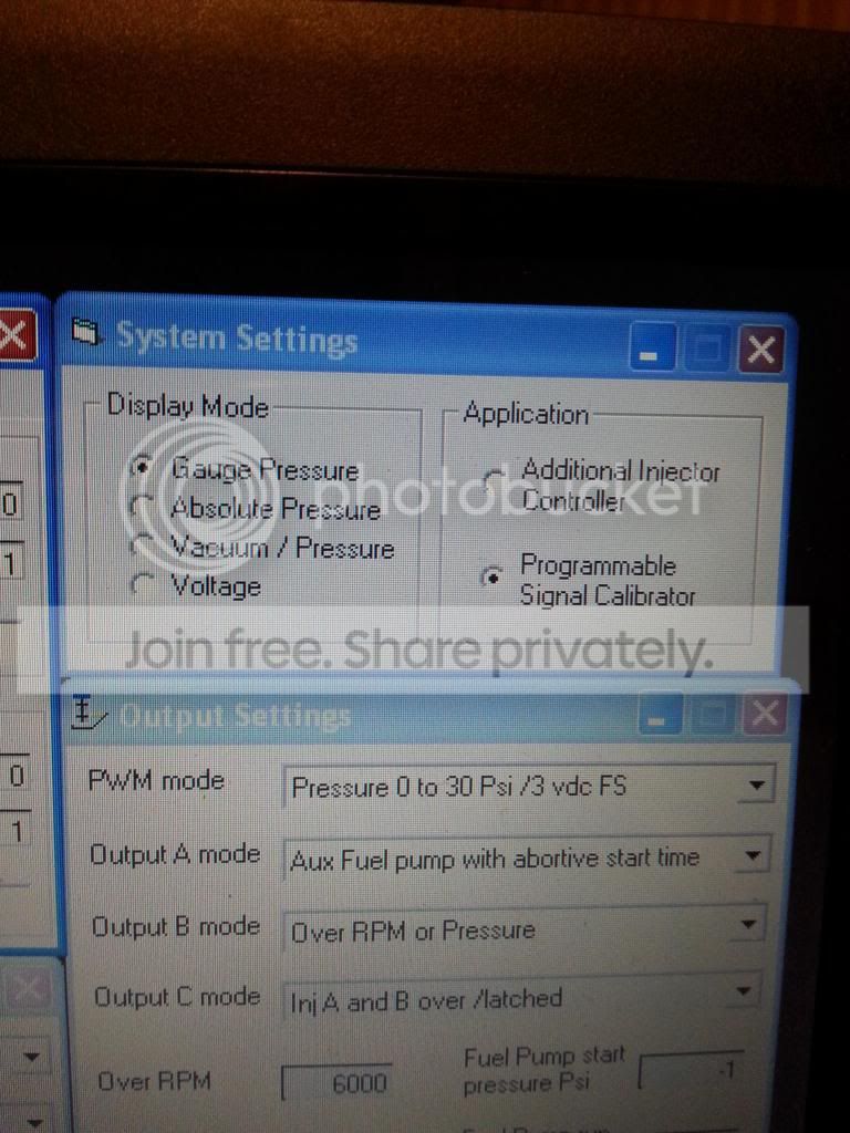

I hope i added the url to the photos correctly... but here are my settings.. sorry for the crappy quality.. camera doesnt like screens.
http://i959.photobucket.com/albums/ae72/larson3ea0/20131206_181434.jpg
The settings are incorrect, the over pressure needs to be close to 0, you can set it to -1, 0, 1. The over pressure is when the AFC starts working so your AFC does not kick in until you are at 9.75psi of boost. The AFC may delay up to 1psi as well so it is best to set the over pressure to -1 or 0.
The display mode needs to be set to vacuum/pressure. Engine settings need to be set to 4 cylinder, 4 stroke. And i'm not sure about the output b but mine is set to Over pressure.
Well I have tried setting the over pressure to 1.1 so it would kick in just above 1 psi but for some reason when I do that my car at idle and out of boost runs around 10.0:1 afr... i don't understand it because I didn't adjust anything out of boost.
Load the super stock map and reset all the settings to default. The AFC does not control the car at idle only in boost. Did you solder the connections?
I didn't install the unit as it was installed when I purchased the car but I made sure everything was soldered to the correct wires. Only found one butt connector but that was for the wideband. I will try to reload the map again tomorrow with the default settings. What would happen if I loaded a map with no alterations so the car would run on only the ecu, completely bypassing the ssafc? How would the car run? I have never driven a msp without the ssafc installed. Any consequenses with my mods? Thanks for the help hornsfan!
You can set all the cell values to 10 and that would essentially be the stock tune. You don't want to do that, there is a reason why myself, the previous owner of your car and many many others have spent time and money on the SSAFC, because the stock tune is far too rich and stock MSPs run horribly.
Load the super stock map and leave the settings in their default position.
