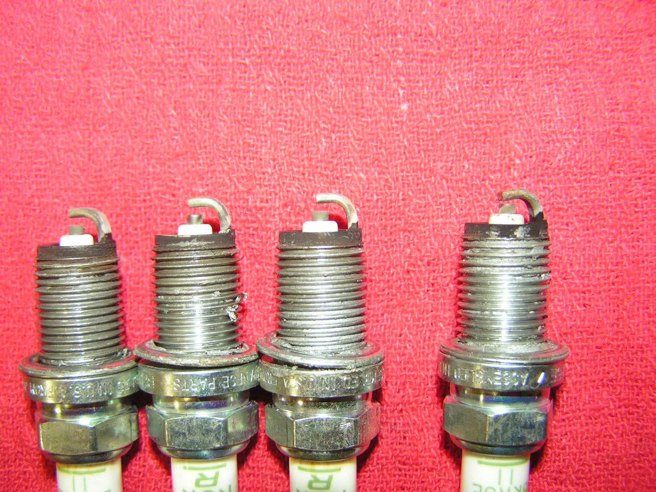

My 2003.5 P5 has had a miss at idle for the past two days. I finally got around to pulling the plugs and one of them has a smashed electrode. Is this definately a VICS screw issue? For the record, my VIN was outside of the recall.
I removed all the plugs and had my wife crank the engine while I looked down the spark plug hole and saw nothing bouncing around in there.
Here are a couple of pics....

Well the smashed one seems a little blacker than the other 3. Not seeing how it could have lost a screw that hit electrode once & then out the exh without rattling around. I guess it could be possible. Did you get a code? Could one single instance of detonation have done that? Curious. I guess you could drop the front of the midpipe & see if you find the screw next to the screen on the front of the cat(if it is still oem). Could the plug just be bad & not burning the gas as much as the others maybe? It would explain it being sootier, right?

Something smashed the electrode. I have not gotten any SES lights. I haven't scanned for codes yet (I have AutoTap). The only thing I noticed was misfires at idle for the past couple days. I'm sure that the plug got a little fouled from the misfiring.
The big questions in my mind are.... is there a screw missing from the VICS now? Was there any cylinder/valve/other damage done? Should I take it to the dealer?
My car is bone stock and has 40k on the clock.

Dealer is a scary proposition unless you go in knowing what's wrong & tell them exactly what you want done. Even then I'd rather go to the dentist. Cool, I have autotap also. Have had it since 98 or so when I had my mustang. I would drop the midpipe & check for screw in front side of cat or put in new plugs & see how she runs first-cheap checks.

Like i12drivemyMP5 said, open 'er up and see if there's a screw on the screen on the pre cat. If there is, there's ur answer.
If there is, you sucked a screw and if you can't do the VICS repair urself, take it to the dealership. If you didn't hear any strange noises and it somehow bounced once, hit the electrode then went out an exhaust valve, chances are it didn't do anything major. If you do find a screw, it would probably be a good idea to get the cyliner that plug came out of scoped to see if anything's scratched up

I'm going to call the dealer. I can certainly do the VICS repair myself, but I'd hate to go to the trouble when the car's under warranty and there's an ongoing recall for the issue. On the other hand, I hate for the dealer monkeys to be wrenching on my car.
There's no doubt something went through the cylinder and smashed the plug. I put those plugs in myself about three months ago.

I think that the screw has been passed through to the exhaust. My concern is that it's now missing from the butterfly and that it may have caused some damage in the cylinder.
Well I drove it into work. Running fine, no rattling, no SES light. I really think the screw has passed through. I'm going to call the dealer and just see how they react.
