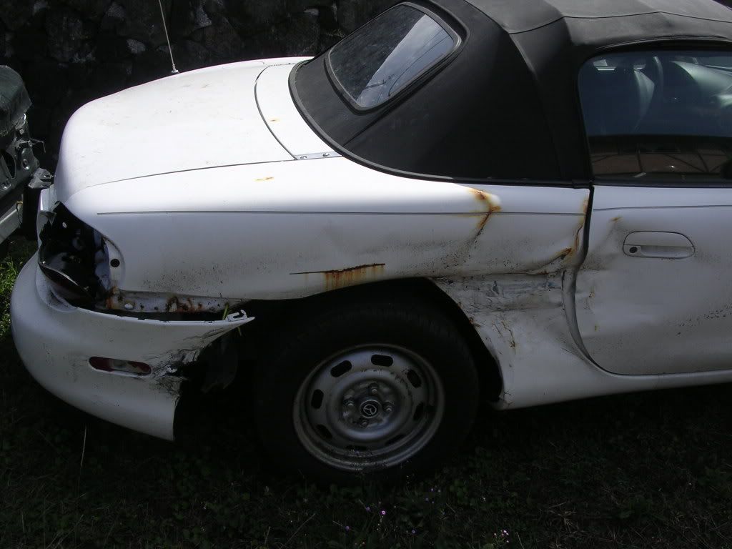

I'm a newby on Miata.net and haven't had any problems, other than someone who was rude when I first got on. The rest of the guys took care of that. It would be nice if the Miata was designed like the RX-7, in that there is a service hole in the trunk floor that allows one to get to the fuel pump without removing the tank. I don't remember seeing that in the Miata. As one said, it could be a fuel pickup problem, maybe caused by the wreck. In the RX-7, the fuel pickup was part of the pump assembly. Maybe some baffle got knocked loose. I've never had a problem like that with any of our Miatas, either.
