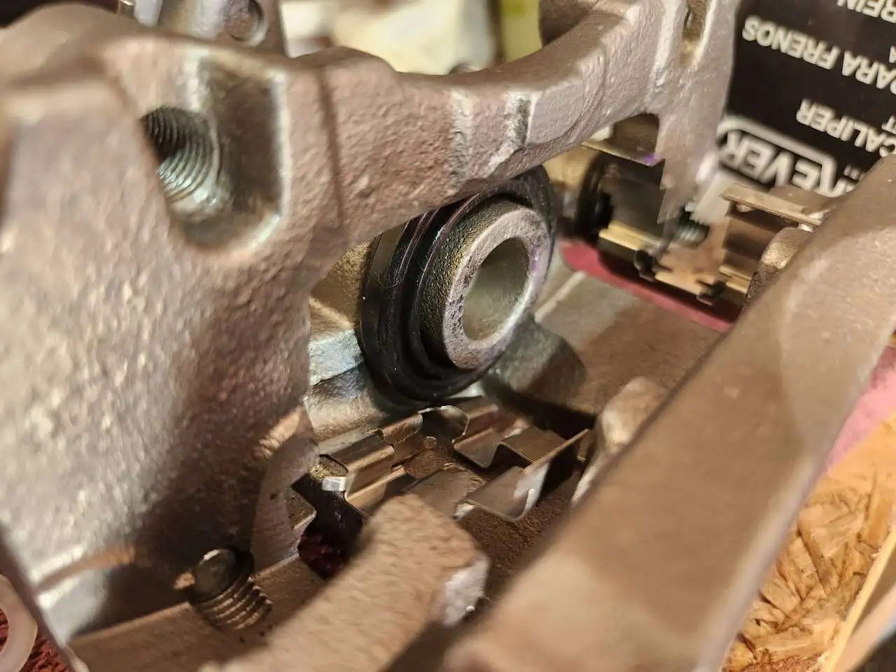

It was the brake calipers... so I got 3 bad calipers in a row from 2 different manufacturers.
Just got a new one from Advance Auto.... see how the piston is fully in on the first pic but sticks out on the 2nd pic... I tried pushing that 2nd one in w/o it connected to the car and had the brake line bolt out... no go it would not compress further.
Strongly suspect the actual piston is too long. Anyway looks like there are some bad batches of calipers. So, check calipers you buy before installing.
