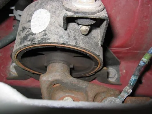

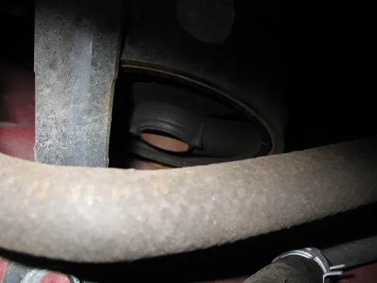

Checked the mount; to me it looks ok. Check my attached pics?

I never noticed that it was shot until it was out of the car. I had checked it and for some reason or another never realized it was totally torn.

I must be an idiot. I'm not understanding this motor mount thing at all. My passenger side one is torn just like in the pics above. All others appear to be fine. Anyway, I can't tell why it would matter if the mounts are torn. That top part is simply like a rubber skin. It's way too fragile to have been supporting any weight, or to stop any substantial vibration. Am I wrong? When I'm looking at the stock ones it appears to me that the business end is the bottom of the mount, and that appears to be fine in the above pics? I don't know...help me out here. If upgrading when torn is necessary, then what do other 5 speed P5 owners recommend as far as durometer? The AWR site recommends 95 for 5 speeds, but others say that will be far too stiff.

Well, after seeing that only the passenger side is damaged I'm not really worried about it now. I'll keep an eye on the others, but this has to be a seriously common issue on these cars. Poor design? I've got to do something about this exhaust because the coat hanger and noise level are making me look like a complete moron on my commute every day.
MSP #3 engine mount installed, old mount indeed torn, driveline slop greatly reduced.
