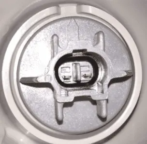

rear bumper fog lights/reflectors.
Legally speaking, I can have fog lights on center or right side of the vehicle.
So, I want to move the bulb and connector, and the cabling.
But I dont want to "cut and solder" any cable. I prefer to connect and extend to the other side.
the car, as bought in Spain, came with rear left side light. and right side with a reflector only, and no housing for a bulb.
So I bought in ebay uk the full lamp. 25 pounds. (I consider is not expensive...)
but I need now both connector, male and female...
any idea?
this is the housing at lamp side.
rgds.
Jordi
I believe you have no choice but tap in the wire to current left-side rear fog. If the right fog housing you got has bulb holder and wiring harness that should be easy. Or I'd try Mazda dealer or eBay to find matching bulb holder and male / female connectors.
I think the connector is this one....
but I only need male and female connectors... no wire harness...
