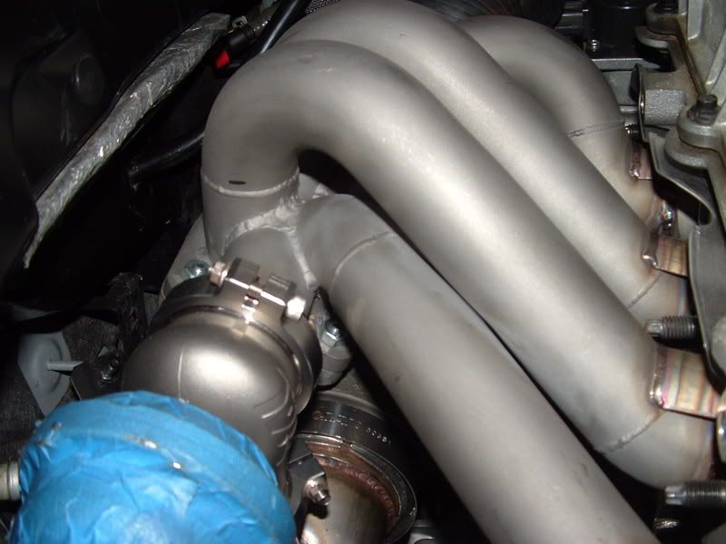

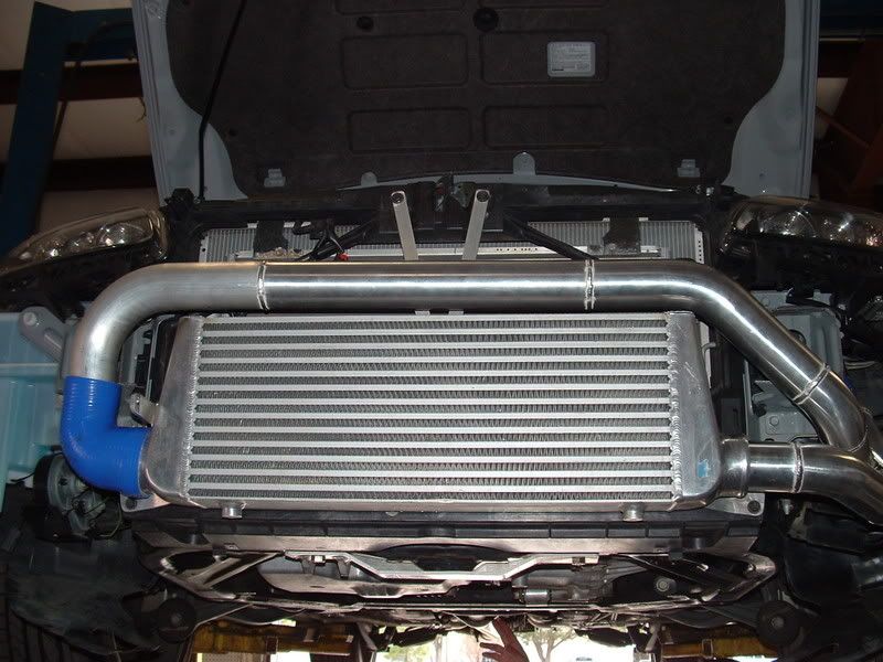

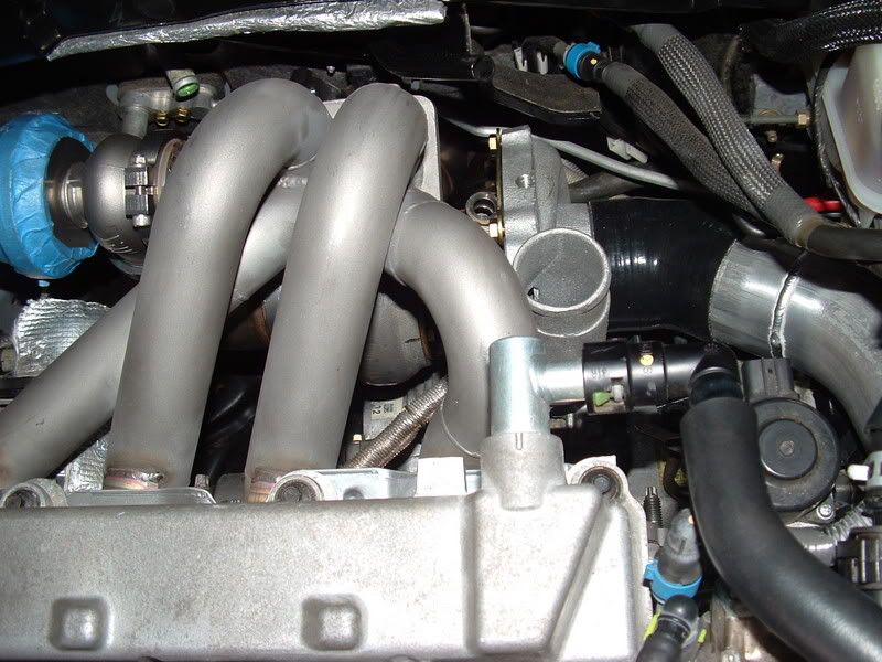

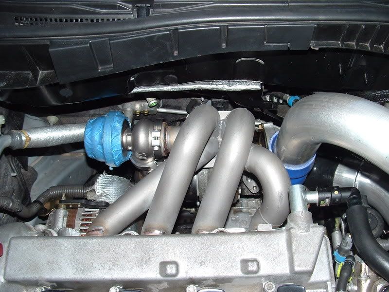

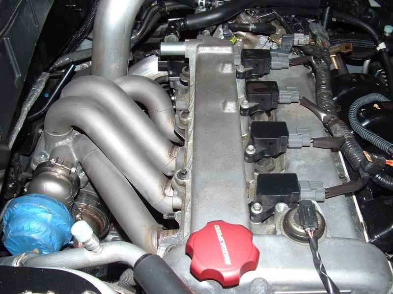

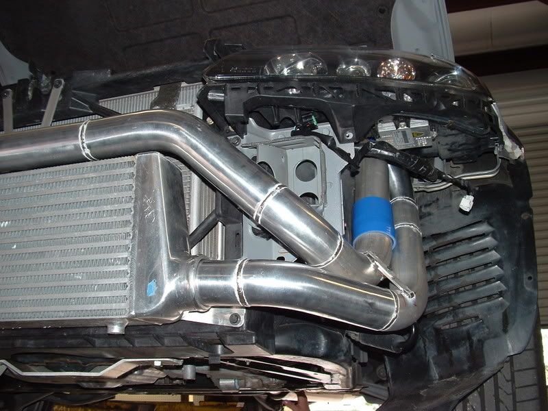

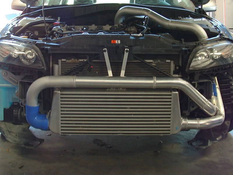

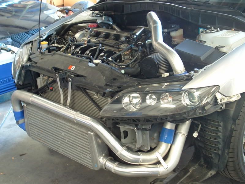

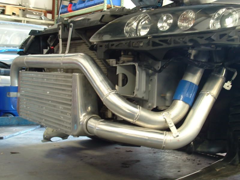

The car is not done yet....these are just some teaser pics of the work so far!! :)

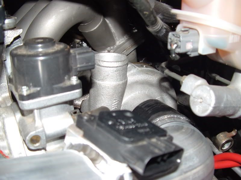

the work looks extremely clean. Where did they put your ecu after they relocated the battery? Which turbo are you using b/c its obvisouly not a t67, and I imagine its DBB since the coolant line is not blocked
Our ECU isn't in the engine bay, like the MS3.
Yeah, like tunersteve said, the MS6 ECU is not in the engine bay.
We are using a t67 turbo, the intercooler piping is 2 1/2 inches in and out of the intercooler. We are using a 3 inch intake and a 3 inch downpipe.
Thanks for the compliments. :)
wow, definitly looking nice. that is some clean looking piping.
can't wait to see some dyno numbers!
Thanks! Dyno and 1/4 mile coming soon. Then the engine build.......

make sure u put a coupler on the other side of the IC lol
