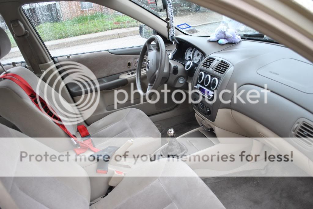

How did you bolt down that harness? looks good!
Thanks! The harness attaches to all the stock seatbelt mounting points. The lap belt bolts down to the lower mounting point of where the stock seat belt mounts and to where you click it to lock it in. Those 2 bolts will hold down lap belt. The shoulder belts go all the way to the back seat seat belts and mount to the bolts that are under the rear seat. If you remove your rear seat you'll see the bolts.
Sweet! Thanks for the reply. Might try this out for myself haha. Didn't know that the belts would reach all the way back where the rear belts bolt in. I hear allot of people talking about getting hurt in a crash because of them not being bolted down right. What are your thoughts?
Bolting a harness to the floor is not at all safe from what I've heard. If you get in an accident you risk serious spinal injury. Doesnt mean people won't and don't still do it...
Well, I have read on this forum and a couple of others that it is not the most ideal because, depending on the severity of the accident, you can suffer spinal compression injuries due to the angle of the shoulder belts. That being said, Schroth has a document that illustrates how to correctly mount them in a car. That's the procedure I followed when installing mine.
Scroth Rallye 4 - Instructions
The instructions indicate that they should be mounted in the OEM seat belt mounting locations.

Don't the Scroth Rallye harnesses have the quick release in the middle of the harness itself and the rear seat?
They have the quick release in the front so you can remove the belts to exit the car. They have another release that detaches the shoulder harnesses from the rear mounting point but it's not a quick release.
