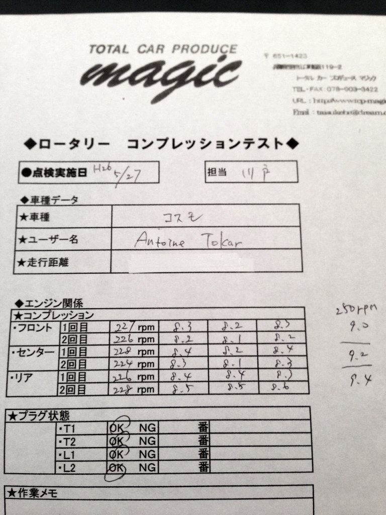

First of all, I've got my actual compression numbers and they look very good (pic coming soon).

Here are my 20B's compression numbers...
In order from Top to Bottom...
"Front"
"Center"
"Rear"

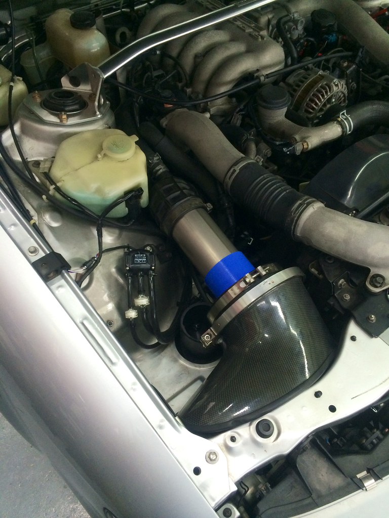

Overview shot of the new setup...

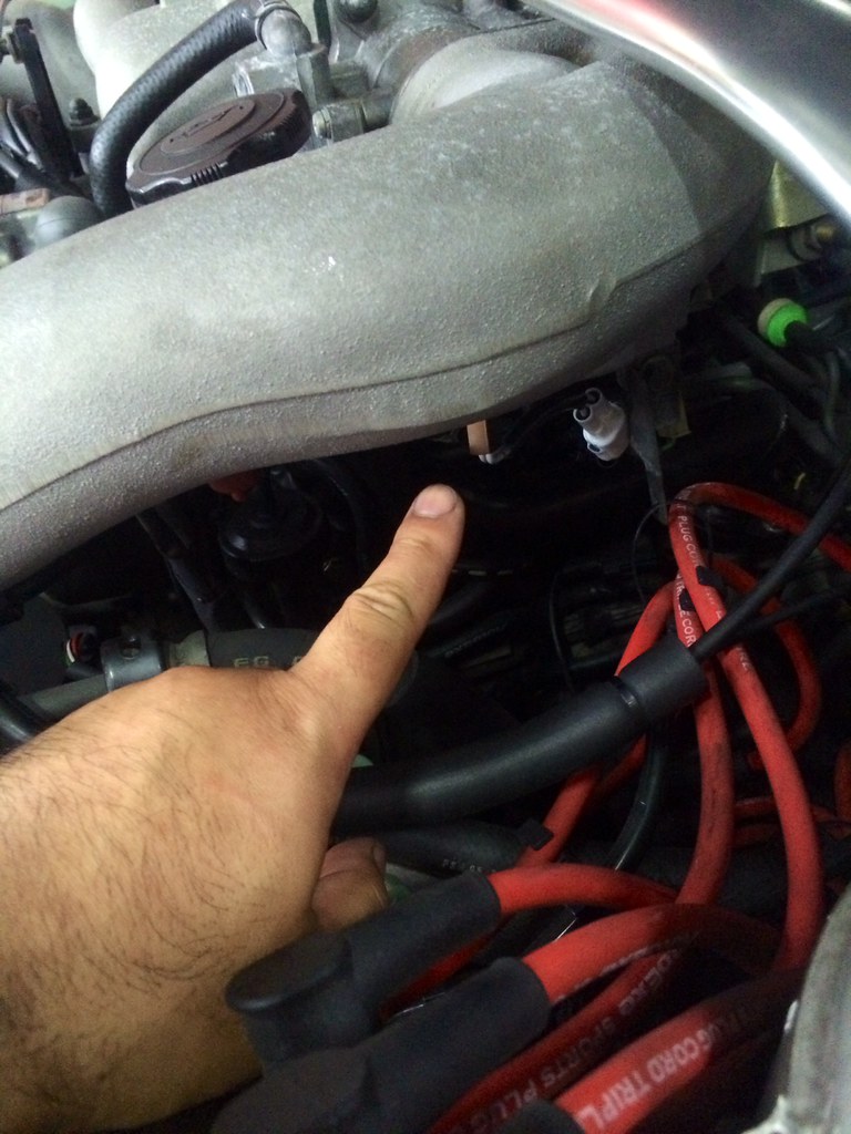

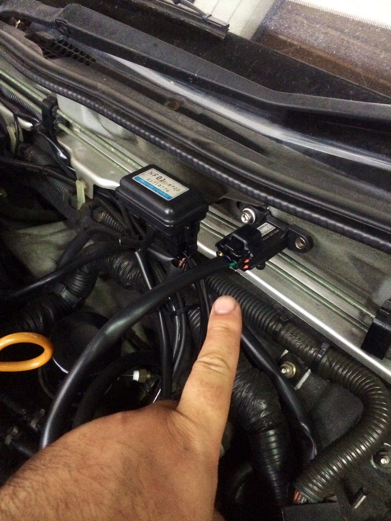

New HKS sensor...

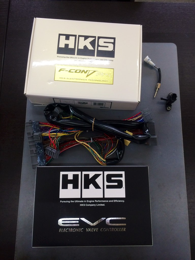

Hello HKS F-CON V Pro and EVC!

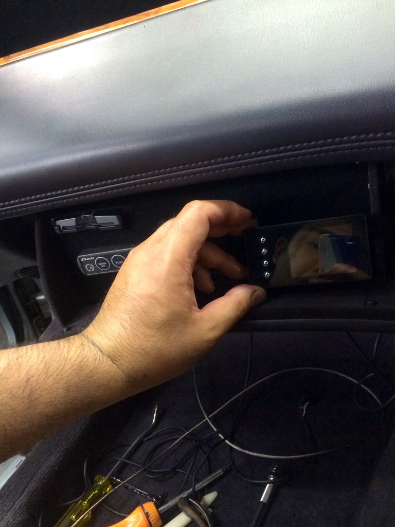

The new HKS EVC display taking the place of the Blitz display...

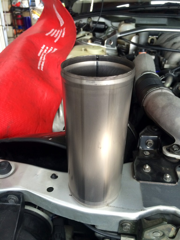

Exciting progress on the standalone. I've been trying to find that intake for the longest now! There was one listed new on YAJ, but it's not there anymore. Are you going to sell the Blitz SBC?
It has been too long since I did a major upgrade...As you can imagine, I can't wait to see the results!
Does AutoExe no longer sell / stock that intake? I ordered mine years ago through a Mazda dealer and I believe it was made to order...Took over a month to get it if I recall correctly...

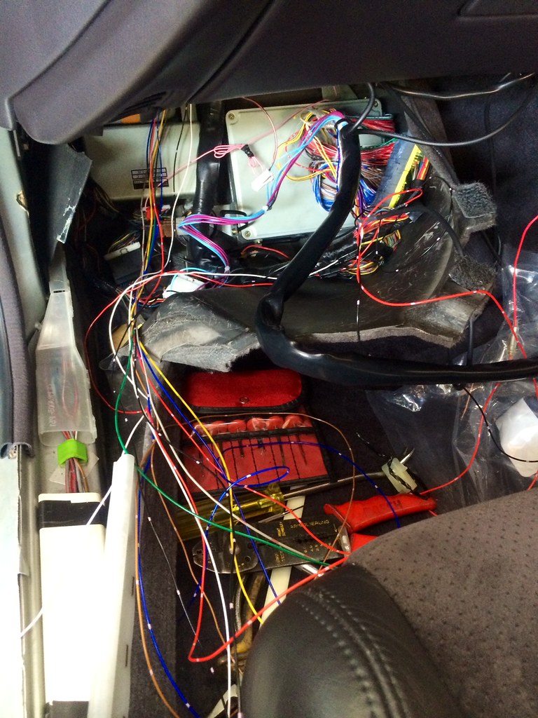

The term "Custom" usually has positive connotations but in this case...It might be a nightmare...Check out what's involved when having to make a custom wiring harness to connect the F-CON V Pro and the Cosmo's ECU etc...

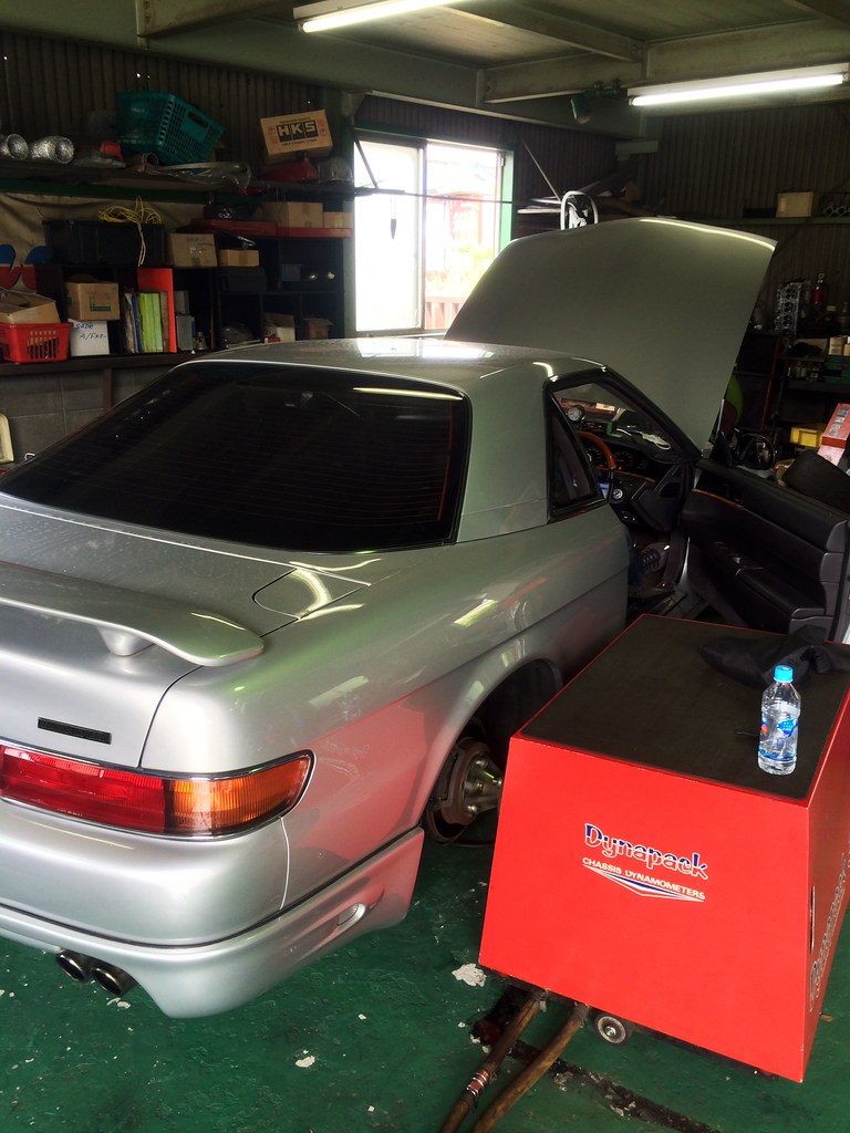

It's DYNO time!
I've got video thanks to Kawato-San!
Here you can see the Cosmo hooked up to a Dynapack Chassis Dynamometer and getting tuned...
<iframe width="640" height="480" src="//www.youtube.com/embed/MYfgYZXnPhA?rel=0" frameborder="0" allowfullscreen></iframe>
Here's the final dyno pull...
<iframe width="640" height="480" src="//www.youtube.com/embed/gWlEFod-gC0?rel=0" frameborder="0" allowfullscreen></iframe>
I'm currently waiting on the dyno results...
