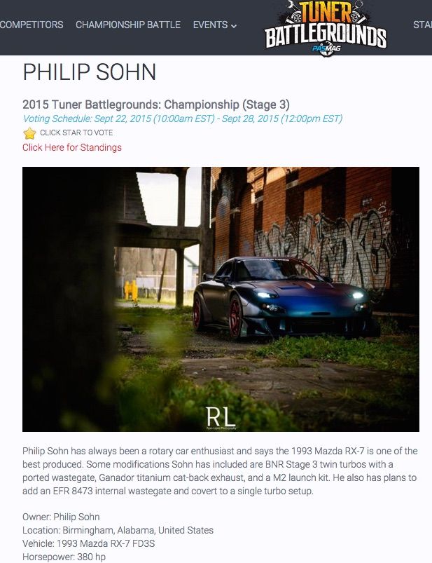

Fellow Mazda Owners!!! I need your support!!
I recently signed up for an online battle where top two finalists get to set their cars to SEMA Las Vegas. I am currently in battle round from top 16 to top 8.... And I'm the ONLY MAZDA left in this competition!!!
To vote for me,
click on the link http://tunerbattlegrounds.com/competitors/909-philip-sohn
click on the blue facebook button
click on the yellow star to vote.
If you can vote for me every day, I would greatly appreciate it. And if you can share the links with other mazda owners, thats even better!!
This Competition is all about the communities and without your support no way I'll be going to SEMA. So, please help me get this 22+ year old car to SEMA.
Also you can friend me on my facebook for updates!
My Facebook : https://www.facebook.com/Herblenny
Thank you for your support!
