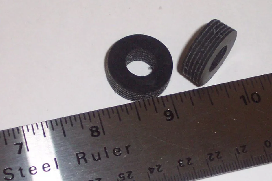

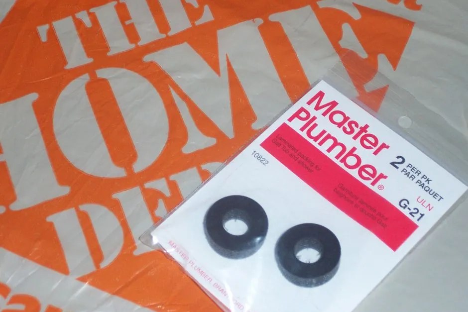

Home Depot is your friend for the AWR endlinks...
Installed (in place of O-rings) over 2 years ago and no problems whatsoever.
That was my next fix but unfortunately I noticed my endlinks were bent so I didn't feel comfortable using them. I think I just had too much preload on the bar for that particular shape.
