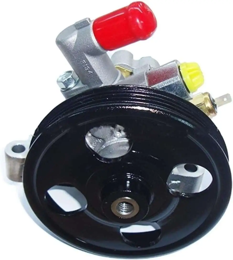

Am I wrong to assume that the power steering pump and the power steering pulley is one unit combined? The parts diagram on mazda parts stores looks different compared to the images if I search the part number LF24-32-650B.
The ones from eBay and Amazon looks like this.
But the one from the official Mazda Parts stores are like this.
Thank you.

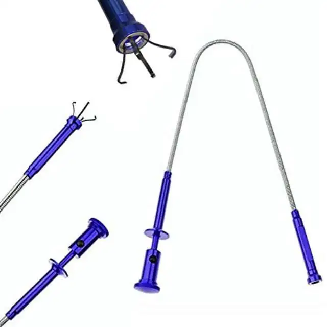

Clean thoroughly under and around the pump. I've used a long 4-finger grabber with a bit of cloth soaked with brake-kleen to get tight spots. Fill the pump to the mark and check the level closely at the same temperature and check for leakage. If it is just a seeper...https://www.thedrive.com/reviews/28507/best-power-steering-stop-leaks

Grabber:

Grabber:
