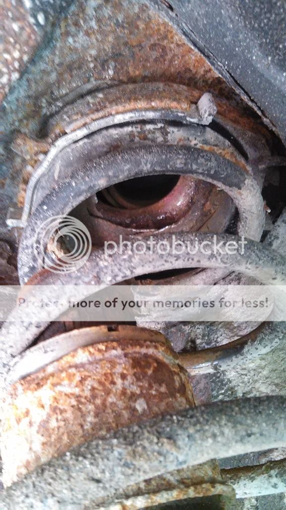

Im impressed the spring is still seated as such lol.
Yea... That was after I lifted the car.
It was as slow clunky ride home. I'm lucky I didn't have far to go and it's not the middle of winter.

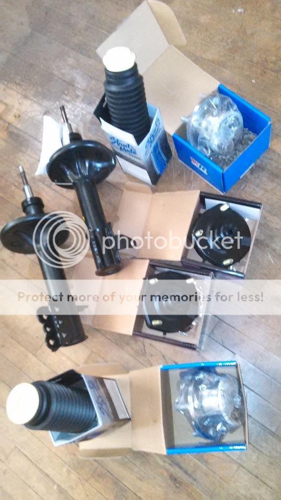

Here's my parts list so far... I'm gonna go with economy rear hubs because they're easy to replace.
I sure hope my front bearings aren't humming too... I don't want to to them over again.

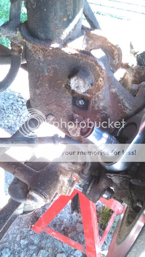

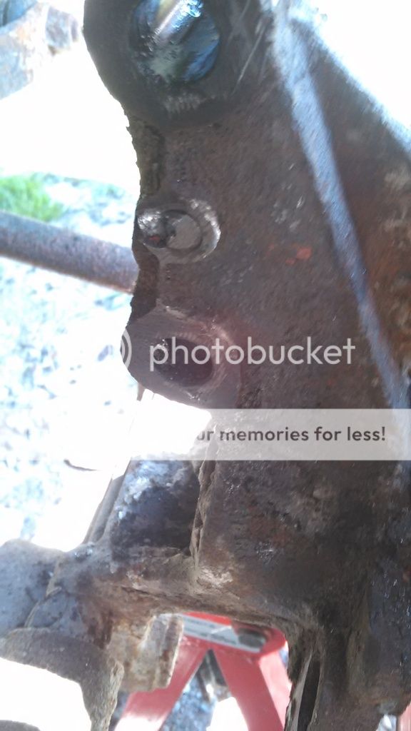

So I tried to drill it out... I missed by a mile...

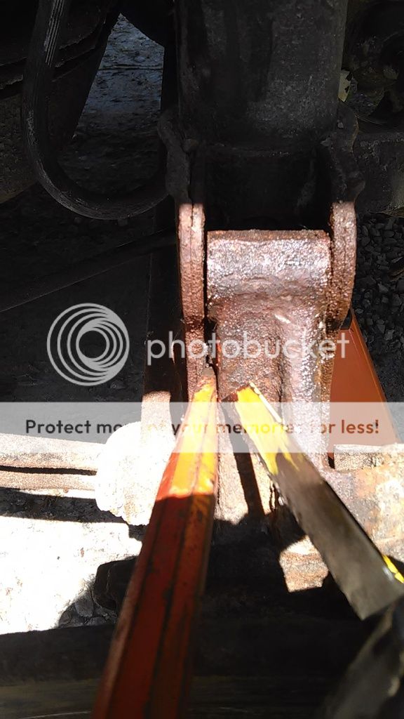

The stud was catching on the strut and I couldn't get the knuckle off so I wedged a chisel into make room for my cutoff saw blade.

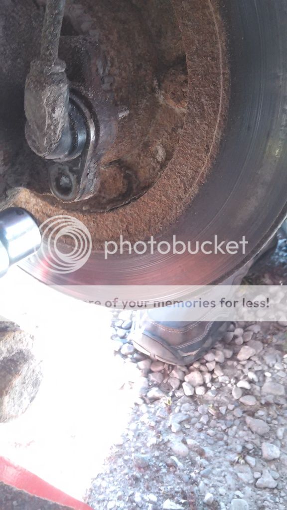

The speed sensor bolt broke too...
Finally got the thing out...

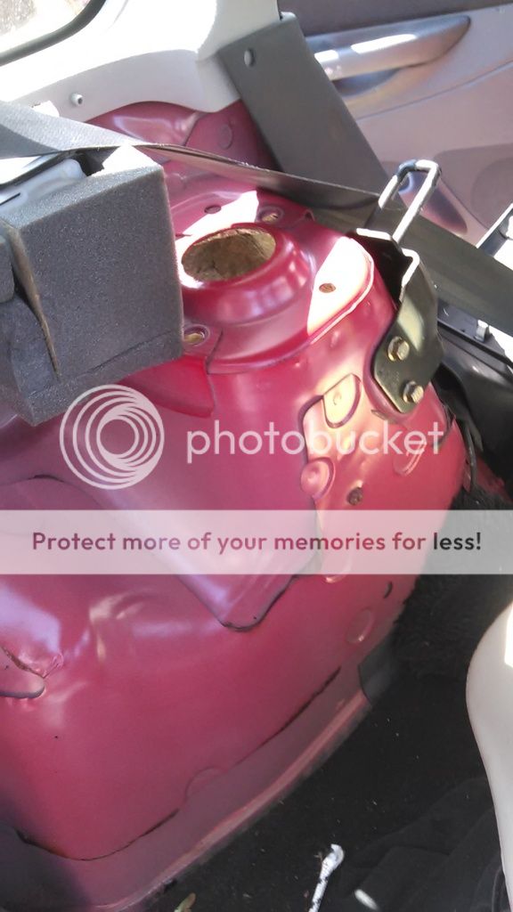

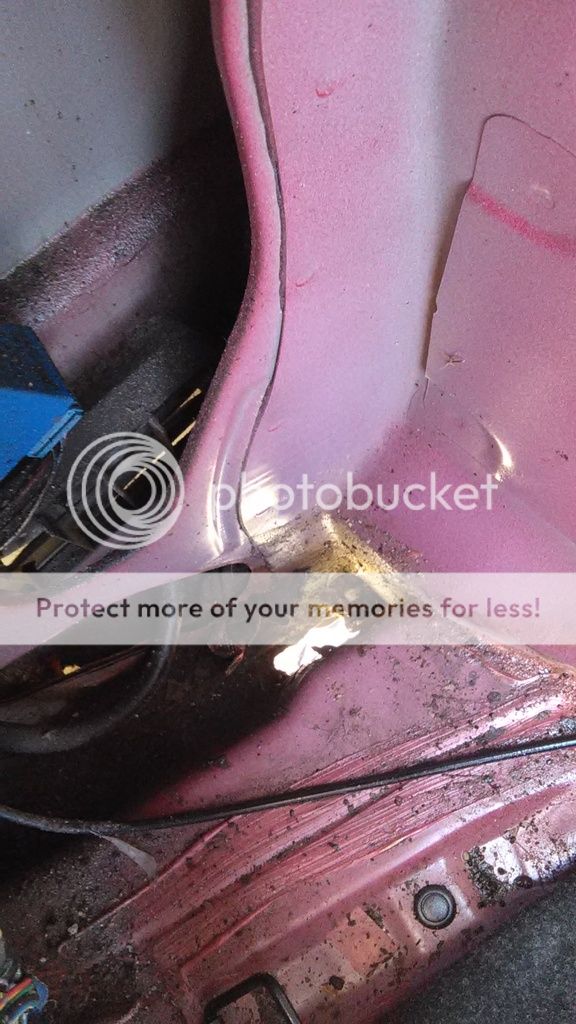

But I rusted through the trunk... I'm just gonna stuff an oily rag in there and call it fixed.

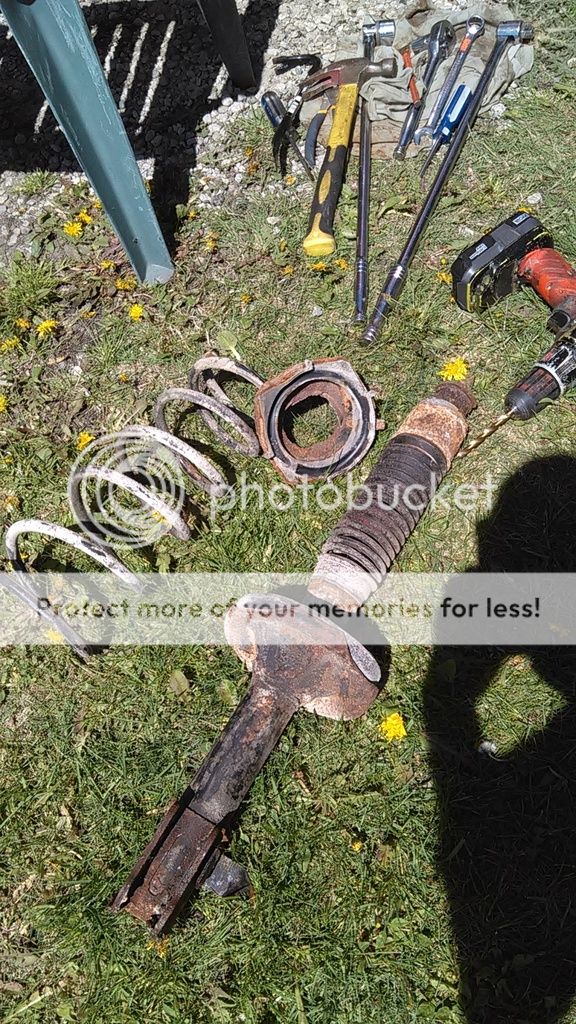

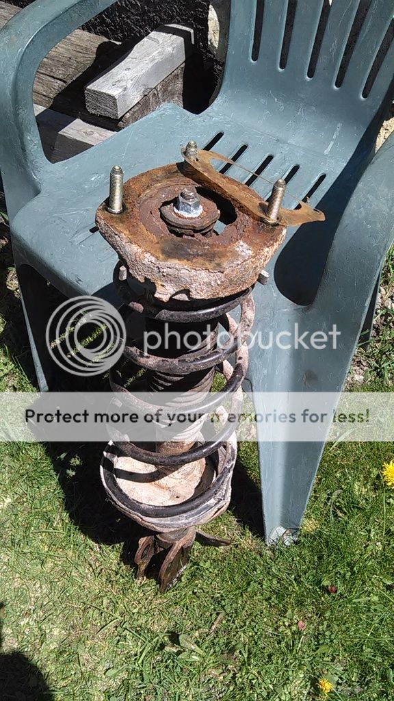

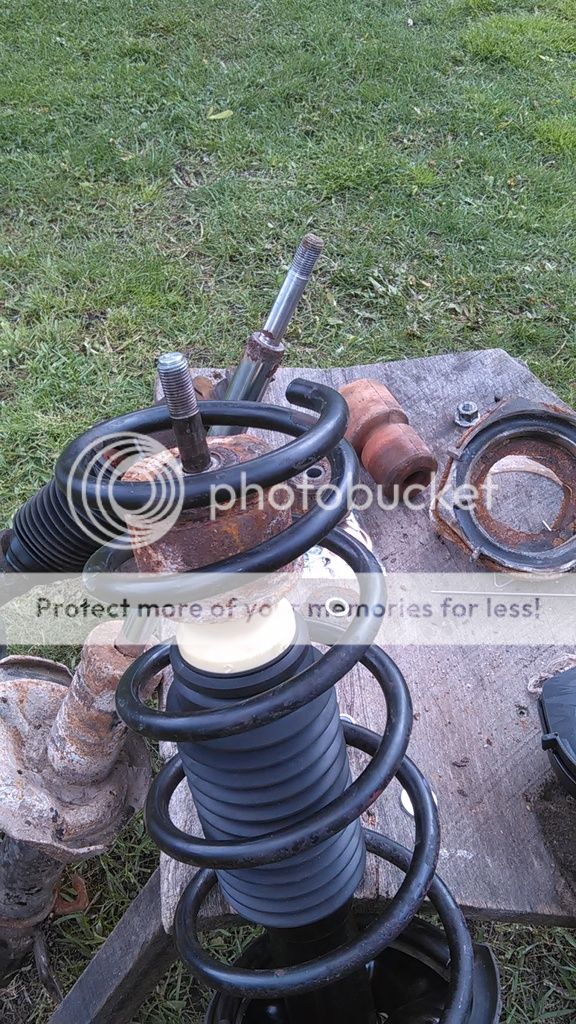

Good news is I don't need to use the fancy SST (spring compressor) to install my new new strut... there's obviously no preloaded.
Jeebus that is one of the worst cases of rust I've ever seen; it pretty much looks like the car had been sitting in water for a week or something. :O
Broke the same bolt (rear speed sensor) yesterday. Got to see rusted backing plates, too. The good news is that the sensor is a super tight fit, so I am going to leave it the way it is and not try to remove the broken bolt.
Same here... I'm leaving all the rust and dirt on it to keep it snug.

Can someone tell me what in looking at here ???
I think it's called the stopper seat but I didn't get one with my new strut or strut mount ??
Everything was rusted together and I thought it was part of the strut mount.
Do I need to re-use the rusty piece of crap or can I just delete it ???
It's not listed as a part at rock auto.
