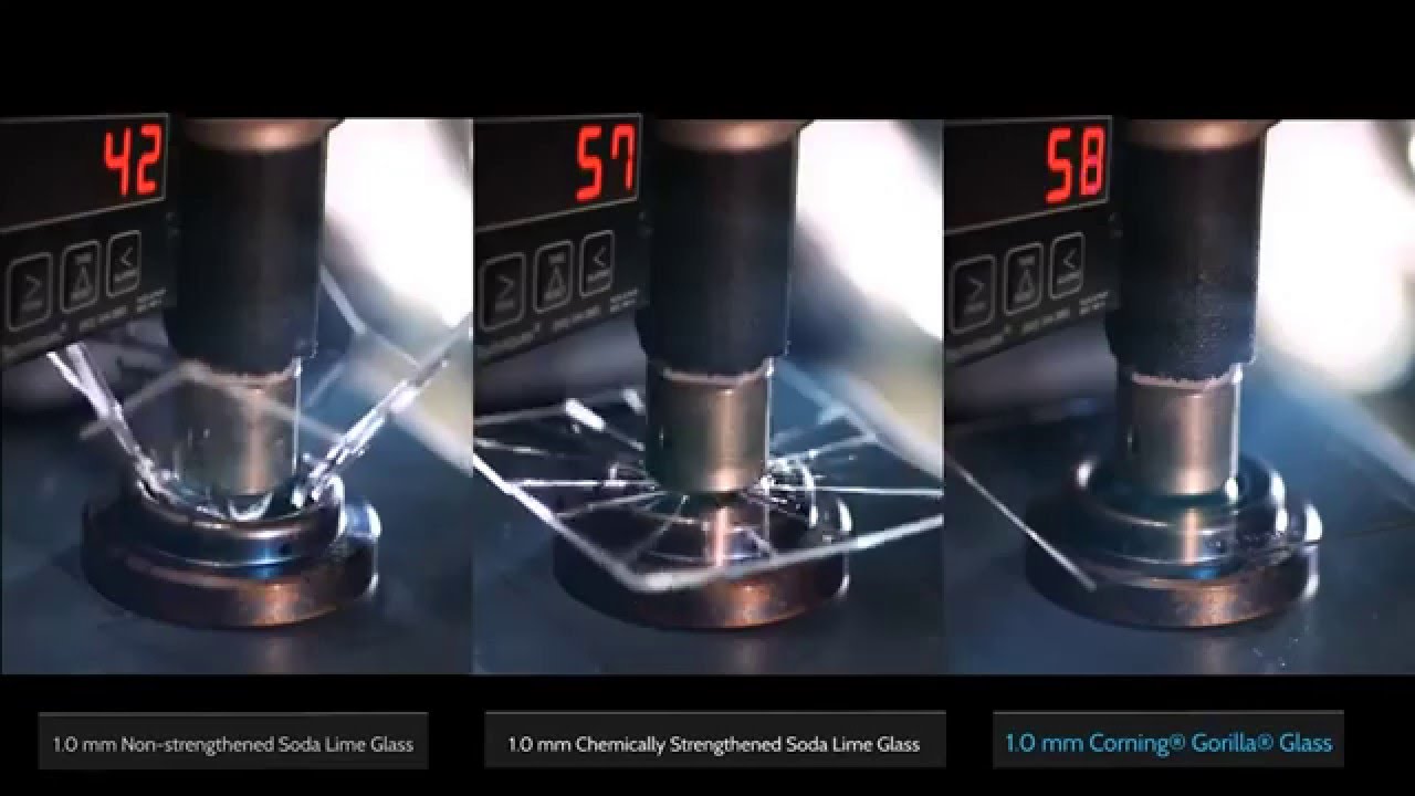

Gorilla glass. Lighter (Mazda would likey) Stronger (owners likey) and more expensive :(
Ford GT uses Gorilla glass though.
I wonder what that would cost, though, considering that the FGT is stoopid $.
