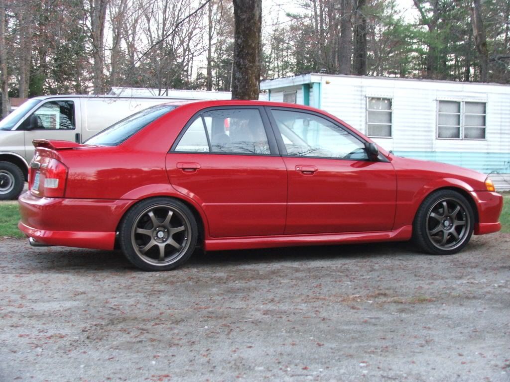

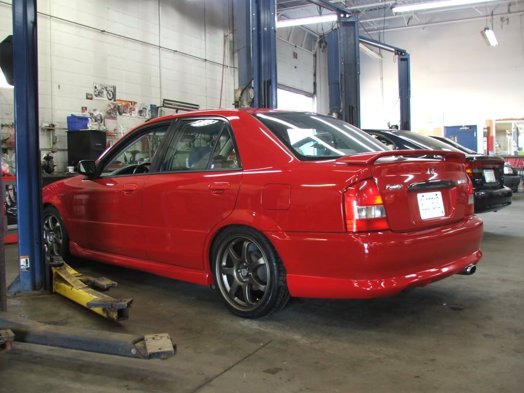

Here they are 17x7 +38 MB Weapons. Wrapped in 205/40/17 Bridgestone Potenza RE050A tires

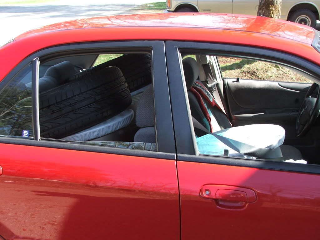

All packed up heading to my friends work:
Just got them all on and off the lift:
At my parents house after dropping off the steelies/snow tires:
what do you think?
HAHA redpro is furious! Copycat!
They look real good though. That's a pretty low offset though. How's it working for ya?
the car is lowered on Eibach Pro-Kit springs and KYB struts, so what is it 1.8" or so. The offset is low and i know every post ive seen says any 17x7 with 205/40 with anything lower then a +40 will rub, but this is how i looked at it, last year I ran a 18x7.5 +48 wheel with a 215/35 tire so i went down 10mm width on tire and down 10mm in offset, so they fit just as flush as the 18"s and never rubbed.
