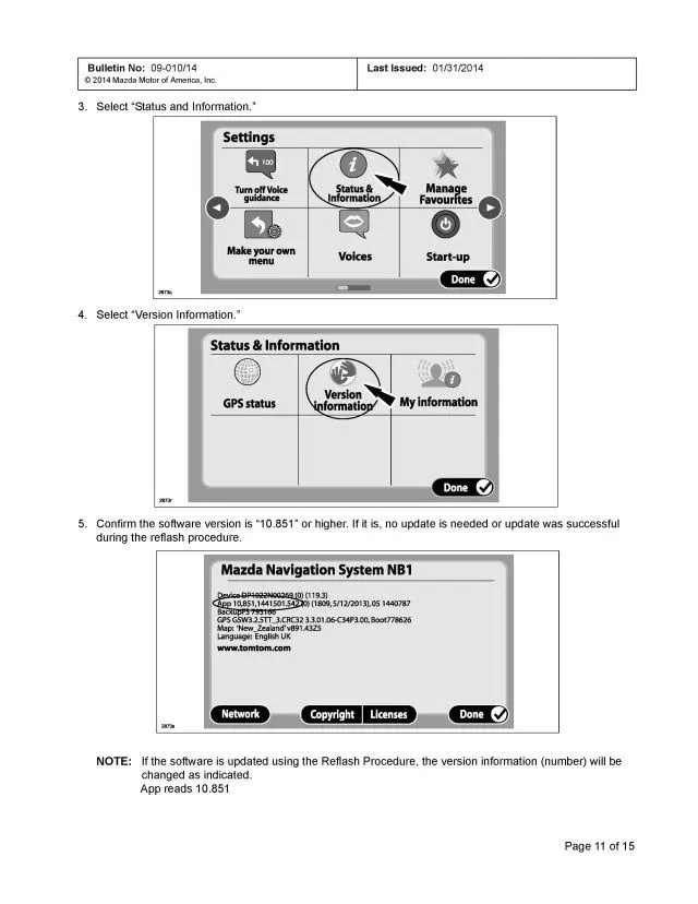

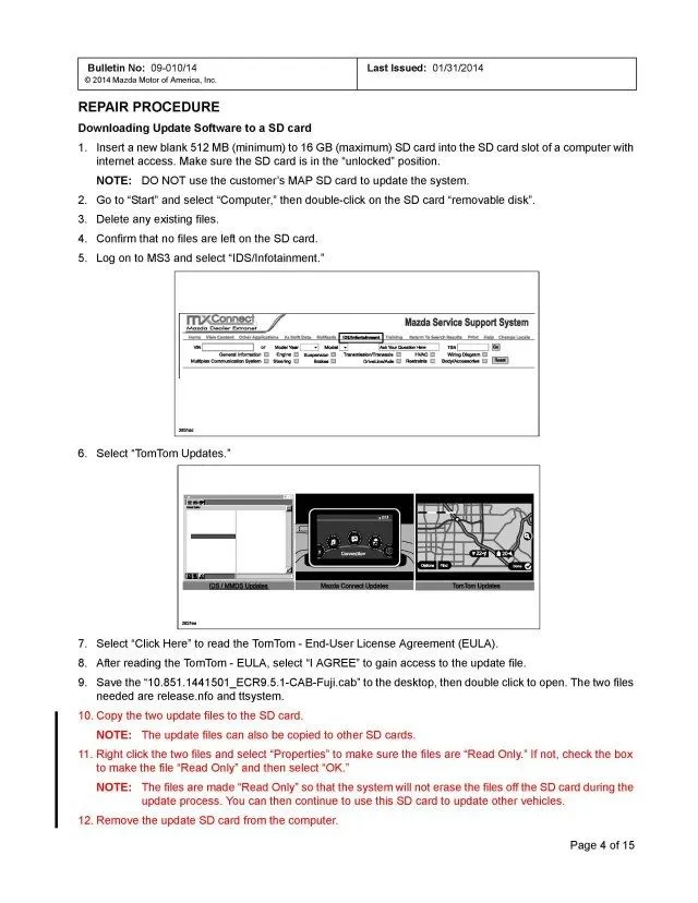

So I just did some more research and re-read the MSP42 TSB.
and yup, I'm correct, IT IS AN UPDATE YOU CAN ALL DO AT HOME THAT WAS RELEASED WEEKS AGO.
The MSP42 TSB is dated 1/31/2014
Here is attached the copy of the TSB telling the Mazda tech to download the 10.851 FIRMWARE UPDATE FILE FOR TOMTOM.
It also then shows the Mazda tech how to check that the updated version is successfully loaded on the TOMTOM.
