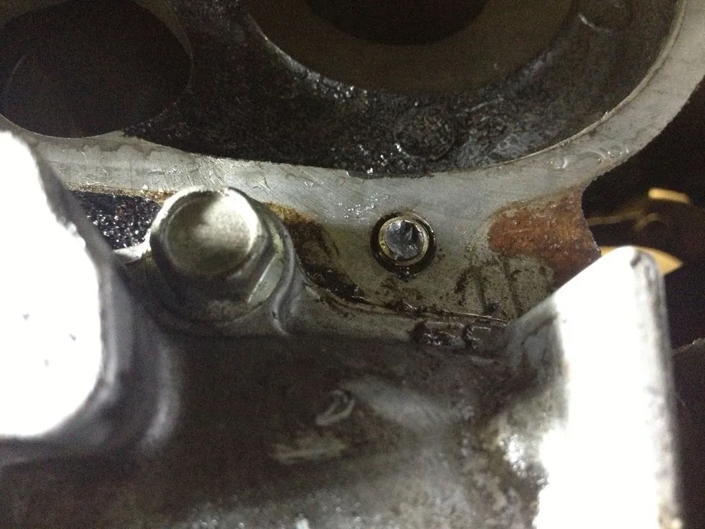

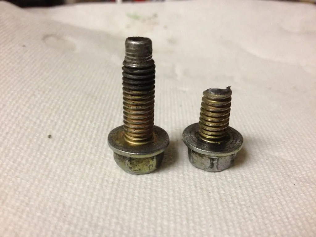

So I was doing my timing belt and borrowed a friends torque wrench which apparently didn't work since I heard no Clicks and the end result is I tore a bolt off in the waterpump when I was tightening it :(
Any recommendations? I am ready to scrap this car I'm so pissed. Will I have to lift the engine out of the car to re-thread a new bolt? I took a few pics of the size of the bolt and where it broke off.

That is really REALLY unfortunate.
To get it out you might have to drill out the center with a very thin (New) drill bit and then once all the way through the bolt, drill a little bigger until you get to a 1/4"
Then use "EXTRACTABIT"
This s*** IS WORTH IT'S Weight.
Before you try to Extract, put the tube from WD-40 in the hold and blast the back of the threads. Let it sit and it should come out slick.
PS. Don't Worry, it's not as bad as I have seen.
Whatever you do. DO NOT BREAK A DRILL IN THE BOLT. It is made of hardened steel and you will never drill a drill out.
Thanks I will give it a shot, i'm not sure if I can fit a drill in the spot...
You might be able to if you support the engine and remove the entire passenger mount.
It's unlikely that he has access to a welder if he had to borrow a broken torque wrench...
