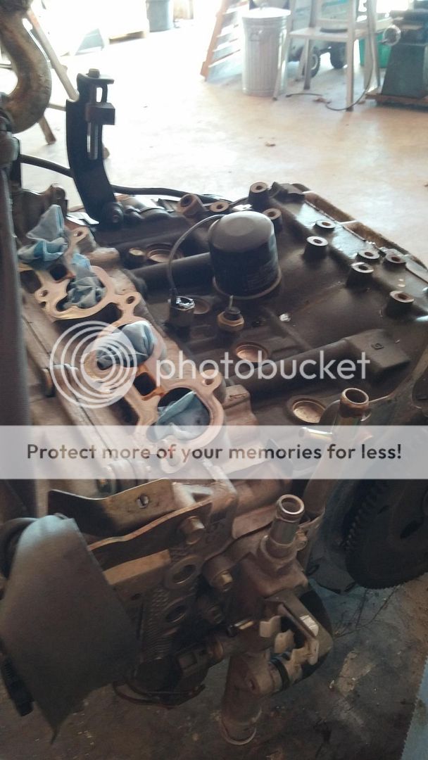

My JDM engine arrived yesterday. So far it looks really good, super clean, oil cap is clean, no sludge.
I will get it up on the stand tonight and start tearing it down to the long block, with plenty of pics.

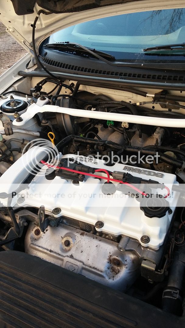

You guys will have to forgive me, I got caught up tearing down the engine and forgot to take many photos. I did snap a couple after finishing:
Here is a break down of the JDM engine thus far.
The Good:
1. Oil pan and pickup were clean, no metal particles.
2. Valve cover is clean, no sludge or deposits.
3. Coolant passages are very clean.
4. Outside of the engine is very clean. No visible leaks.
5. Appears to be low mileage like the seller said.
The bad:
1. Upper timing belt cover was broke.
2. Throttle shaft was bent.
3. Whoever banded the engine to the pallet did it right on top of a coil pack, breaking it.
4. Engine did not come with starter, so I can't compression test it yet.
5. This engine is an FSZE, not an FSDE like the ad says. The intake cam is stamped FSH9

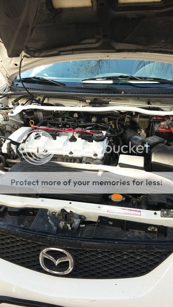

In case anyone is still reading, the engine swap is done and finished. In my usual style, I got caught up in the job and forgot to take any pics.. Nothing really groundbreaking anyway.
Everything went well. Had some trouble with the axles being seized, but I didn't have to remove them anyway. That's something I'll have to deal with later. My engine mounts are absolutely trashed too, so I am gonna order the set of those today.
The engine runs perfectly smooth and powerful, except for an occasional loping idle. I don't have a functioning PCV yet, so I will replace that and see if it helps. I did plug the vacuum hose though. We'll see what happens. No DTC's yet except for the P0037 which I had before the swap.
The Exedy clutch works perfectly. The old disc had a lot of friction material left, but the release and pilot bearings had a lot of wear. I think somebody might have thrown a clutch disk in it but didn't replace those parts. Shady.....

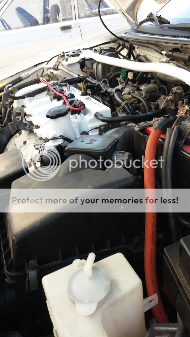

This morning I was getting a P0171 code which I hadn't had before. Having the PCV out lets un-metered air into the intake tube, through the tube that runs into the valve cover. Took me a bit to figure that out. Air getting in past the MAF=lean condition.
I cleared it and installed a new PCV. So far it hasn't come back.

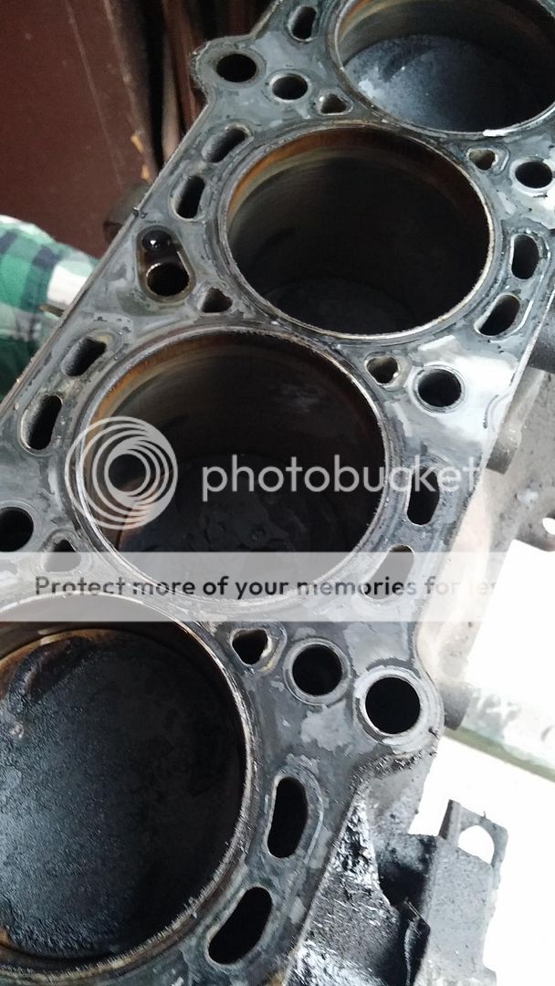

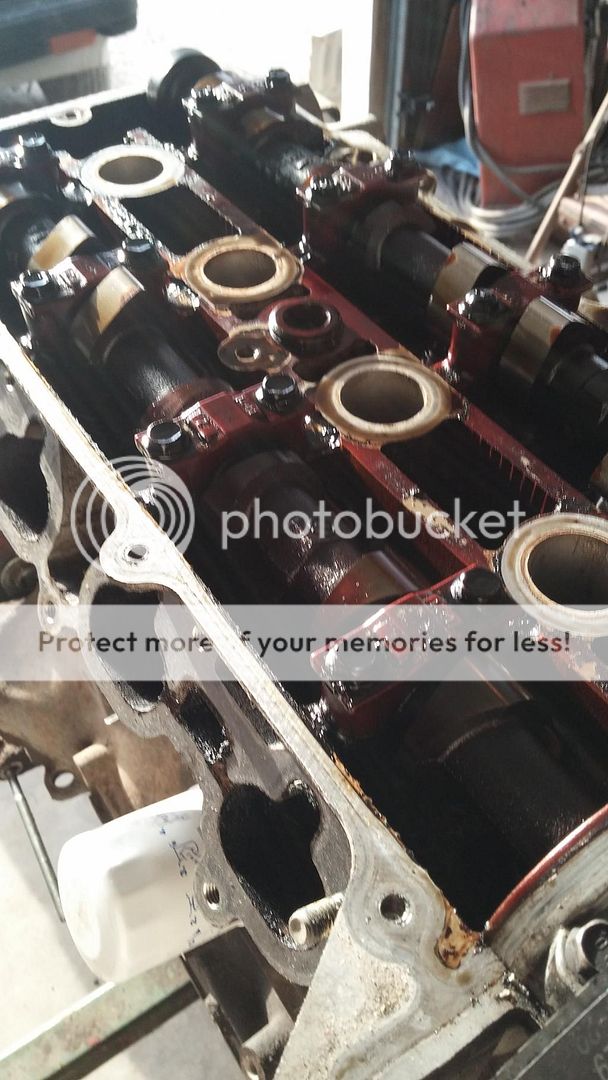

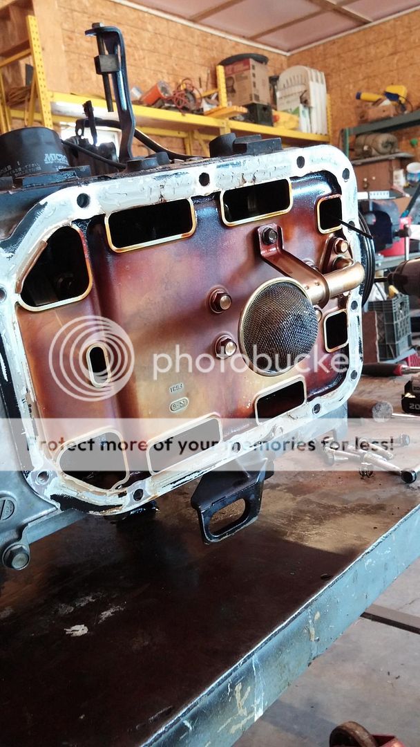

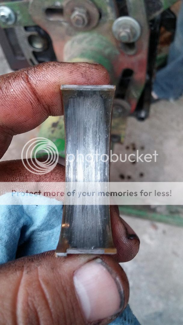

Well I continued with the postmortem examination today. Confirmed my suspicion about the stuck oil rings.
This engine had a lot of sludge in it. The previous owner was not good about oil changes. Lots of oily carbon on all combustion surfaces. It was so bad that you could see where oil was running down the front of the motor, leaking out of the exhaust.

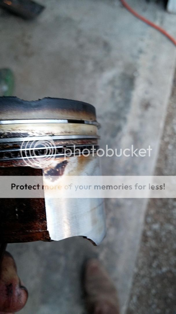

This is the side profile of the stuck oil ring. You can see the difference in the compression rings, which were still very free. Pulled two pistons and they were both stuck.
The bearings weren't in great shape either. Another injury from poor oil quality. They should barely be worn into the brass at 160k.

Good analysis, those oil rings are a problem. I think all those problems could be avoided by changing your oil regularly! Unfortunately, this car was cheap off the show room floor and was treated as such...
Did you paint your plug wires red??!? That looks fantastic with the white valve cover. Well done!

Thanks. It turned out pretty good, considering I'm not much of a painter. After painting I sanded the raised letters down, and hit it with some clear. I'm curious to see how well it will hold up.
The wires are some sort of aftermarket that came with the car. I didn't paint them.
