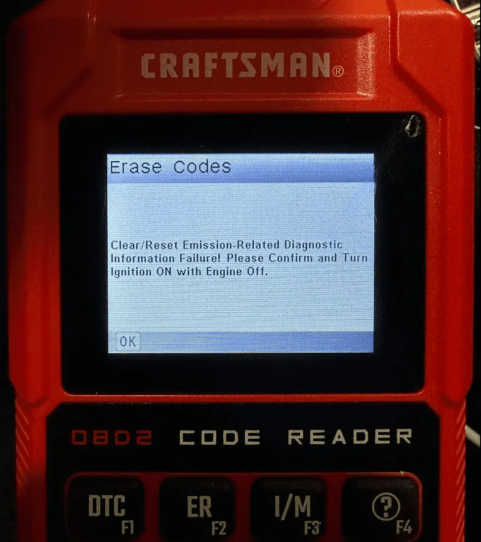

Thanks for this tip! When I erase the codes, it erases everything except the three permanet codes.

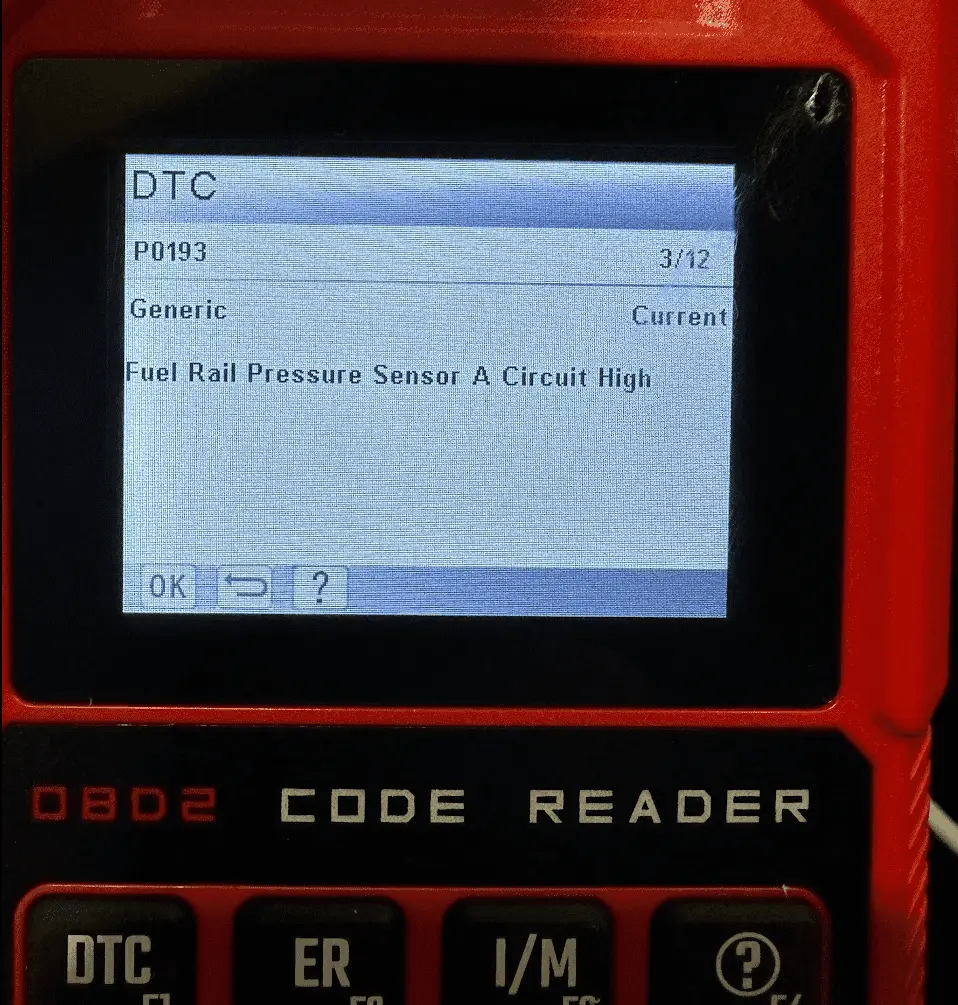

And after I unplugged the three sensors and put the car in accesory mode again, I got the circuit high codes for those sensors even though they are unplugged. Is that normal?
Yes, if you unplug a sensor, you will get a circuit error; typically "circuit high".

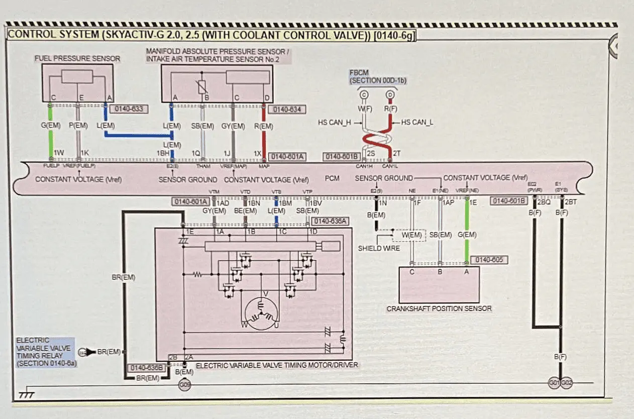

Wouldn't failure of that sensor cause the engine to have no spark and just dump fuel? And would I not be getting an RPM reading?
I was able to start the engine with it plugged in and the tach was working fine. Are you saying that the P0335 code isn't for the sensor in this circuit here? Because that would make sense since the 3 permanent codes are the sensors here in this diagram.
