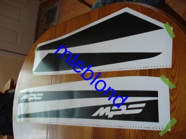

I'm so tempting to do it,actually I was in the group buy at first but then got out cuz I screwed the black roof overlay installation(bluebatmobile),well it's not really my fault cuz it's not well precut,so I was worried about the samething might happen to these stripes
so they come precut or you need to cut 'em urself?
come like this?

They come just like in the picture...the only cutting you need to do is trimming between the rear doors (gap) and 1/4 panel and the hood to fender gap; oh and trim at the front of the hood.
Other than that just use really soapy water so you have plenty of time to adjust the position of it. The hair dryer really helps out to make the stripe conform to the shape of bends and curves. Inspect 2, 3, 4, 5 times if you have to before drying it out; make sure everything is perfectly aligned and equal on both sides.
