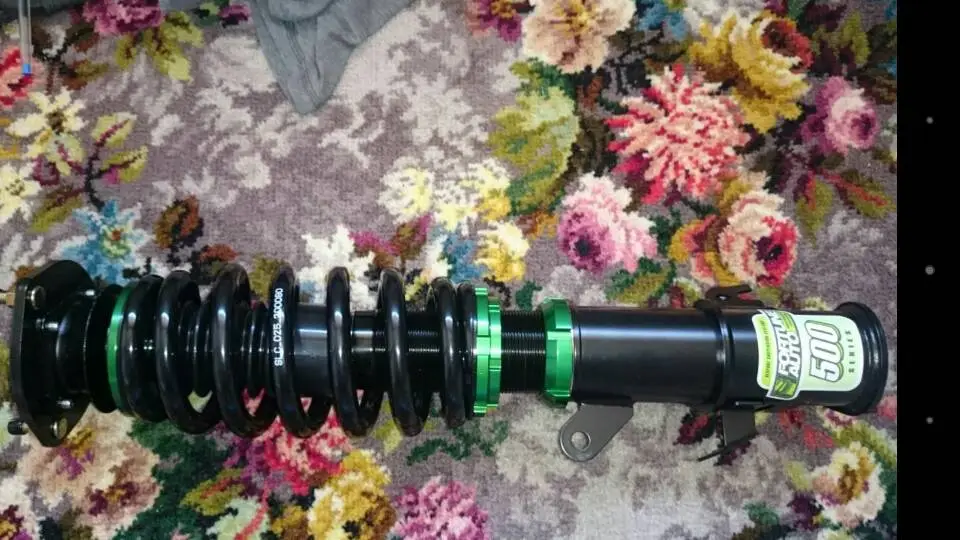

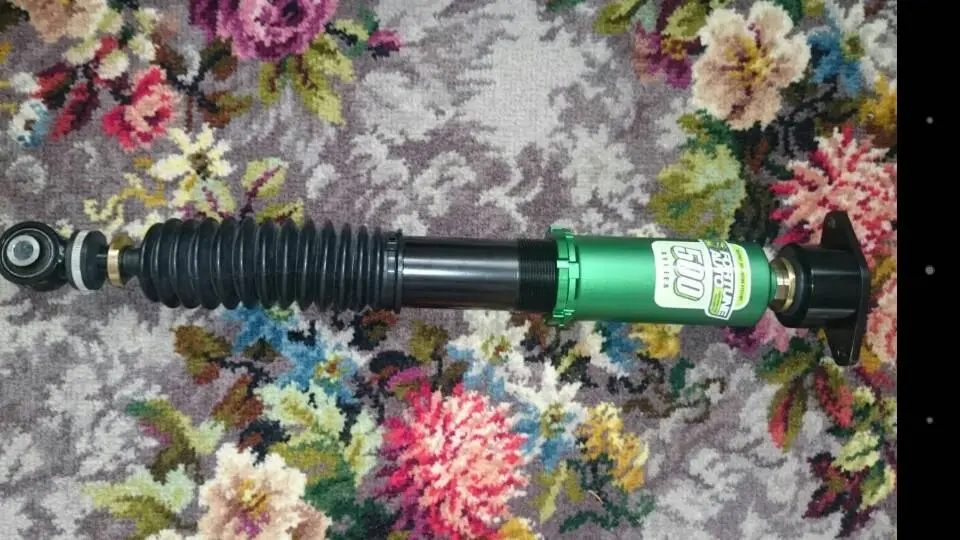

Here are the pics of the shocks if anyone was interested

OK so after seeing the pictures it looks like your shocks are length adjustable so I would check to see how much travel you have, and then see where you stand when at your ride height. You should be in the middle, or a little less compression to the bump stop then droop to where they are all the way down. I would be curious how much travel you have on those.

What spring rate are they running and how heavy are their cars? 8k/450lb springs are pretty aggressive for a 2300lb car, whereas 8k springs on something like a 3500lb evo would be probably only a little stiffer than stock. Also from that picture, your rear shocks are set pretty damn low. Are you sure your rears are not set with some crazy pre-load? I have about 1/4" preload both front and back.
@Zach, spot on. The fortune 500s are length adjustable and have a decent amount of travel. I believe its somewhere around the vicinity of 2" from loaded to full droop but I haven't measured exactly.
The pics are from when I took them fresh out of the box. We adjusted them after I took that photo and changed them another time both front and rear. Front was raised and made handling and ride better while the rear we shortened the shock to full captive of the spring and it seemed a tad bit stiffer but more controlled than previously.
