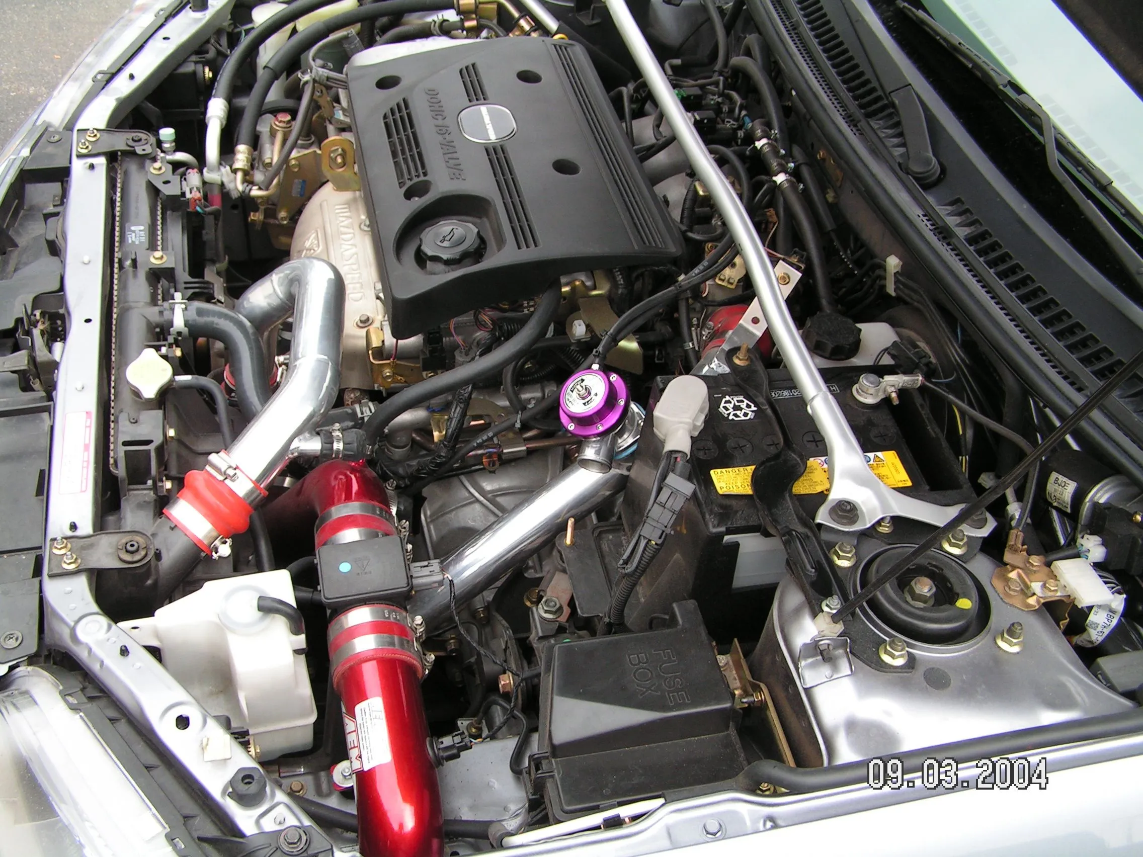

God not another one of these threads... you can run the hardpipes, BOV, and no BPV perfectly fine with no stalling issues or problems what-so-ever. But if you want to keep the BPV more power to ya.
I said it before and I'll say it again. It depends on your setup. I'm not denying that you don't have problems but you can't deny that I've been having many issues with one bov. Either I stall or I get compressor surge. I screwed with it for about a month then SPD did. Finally we just put the stock valve back on to work in unison with the aftermarket valve. No more issues.
Tom, I'll show you my setup. No stalling or compressor surge.
thanks Peter.. let me know when. im off on sundays.. i can drive to SD or meet u at SPD.. just let me know.. and is it easy to do??? i have the turbo xs bov?
sorry i keep losing you on IM. I switched comps hit me up again. Your gonna need hardpipes to do this. No sense in using stock pipes.
