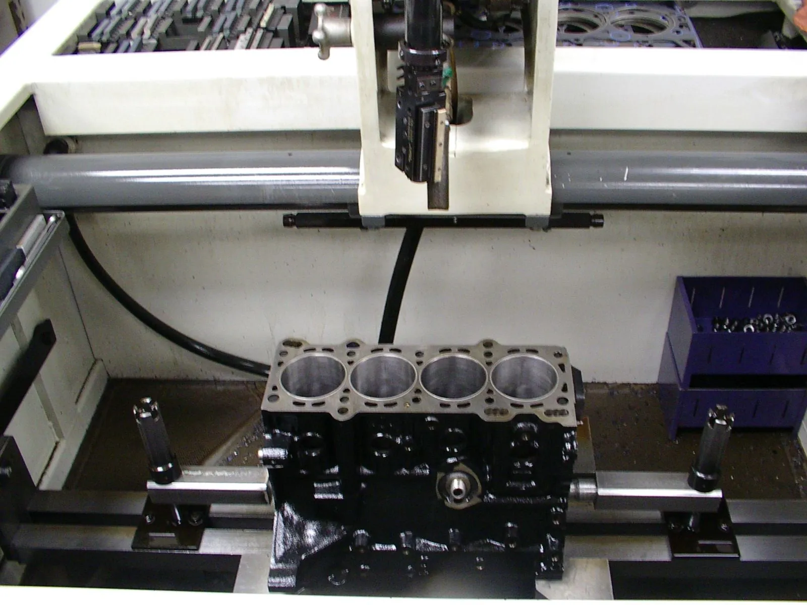

This first image is the block mounted in the boring machine. All four bores will be bored and honed in a center line. This is important because my block had one cylinder off center--this process corrected it.

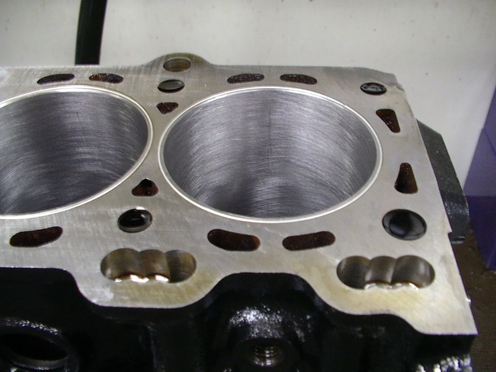

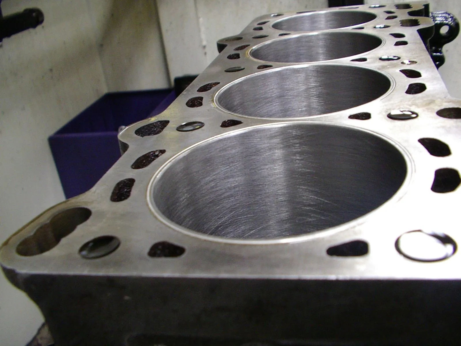

In these pics you can see the honing job. I had my deck milled and fitted with an o-ring for my copper head gasket--the oringing would be an additional charge.

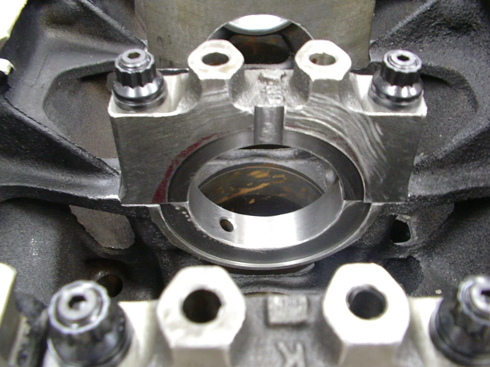

Here you can see where the thrust bearing cap has been machined to accept a top thrust tang. This tang provides extra surface area to support the crankshaft as you upgrade your pressure plate/clutch (crankwalk). You can also see that the oil ports are chamfered. The casting flash on the inside of the block is still visible in this picture, but it will be removed by the machinist.
And notice the ARP hardware. :D
