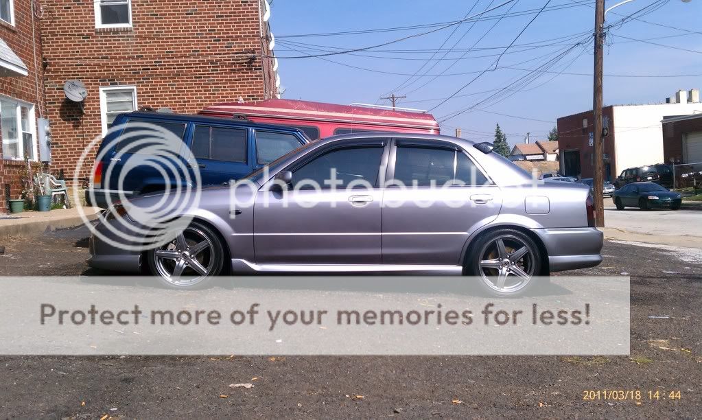

I'm still running them in the front but I switched to eibach in the rear.. this is an old pic but the rear sits a bit high, also the springs get all rusty after a year.
Hmmm, that doesnt look bad, I like a little bit of rake. Anymore pics?
Was that on stock MSP struts?
How did they feel?
I had bought them off of mazdaspeedstore.com they were like 120.00 shipped iirc
They def felt tighter on turns, kept the same ride pretty much too, the front goes pretty low , the rear kinda sits high depending on where u park.

I'm just wondering if thats on the stock MSP struts or replacement sedan HPs. Because if they're replacements then that would explain why they dont sit as high due to the lower perch than whats on the MSP struts.
