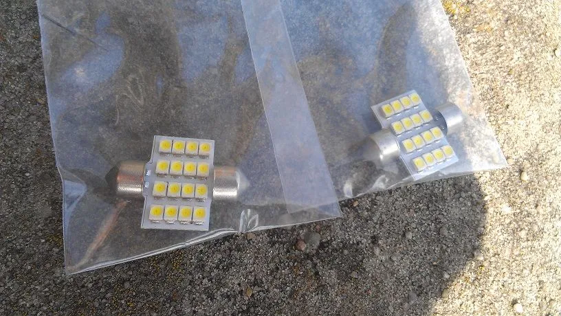

So the interior lighting for the front map and rear dome lights are all festoons. I ordered two extra pairs (4 total) and have no use of them. New. Direct snap in replacement for the festoon dome light. 16 LED's, color output is PURE WHITE.
$12 shipped for each, $20 shipped for a pair, or $30 shipped for four... U.S. buyers only, don't want to deal with international shipping.

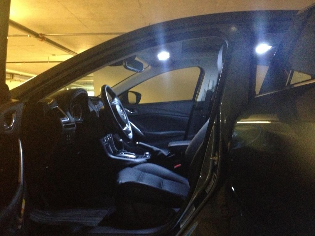

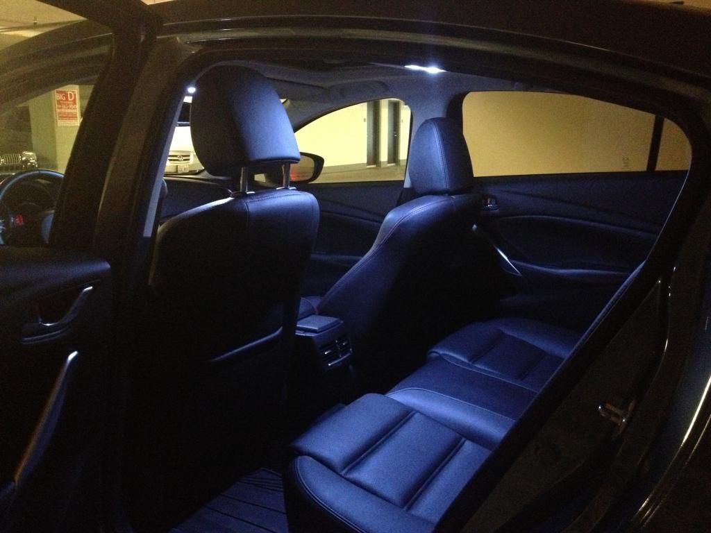

Hello,
The Natural White LEDs from SuperBrightLEDs match perfectly with the shade of white in the gauges and controls. This setup cost around $30.
Pardon the crappy iPhone photos.
Hello,
forgot about my vanity mirrors and glove box. good job!
Thanks Blackzilla, I'm still messing around with the setup. Can't decide if I prefer Natural White or Cool White...
bulb list for the project? Vanity mirrors especially awesome. did you do the bottom of the doors too?
Thanks! The project covered all of the stock bulbs in the car (except the head and fog lights), so door lights were included.
194 from SuperBrightLEDs, Natural White (WLED-NW5)
- 1x for glovebox light
- 2x for courtesy lights (doors)
- 2x for license plate lights
DE3175 from SuperBrightLEDs, Natural White (3022-NW4)
- 4x for dome lights
Fuse LED from SuperBrightLEDs, 6V (F30-WHP-6V)
- 2x for visor lights
74 from VLEDs, 5000k (74_3_W_5K)
- 1x for trunk light
The brightness of this setup is perfect and the color matches the color of the gauges in the dash. The whole thing together looks very stock. I had a chance to compare the color and intensity of my setup with OEM LEDs from a late-model Lexus IS and they come pretty close.
