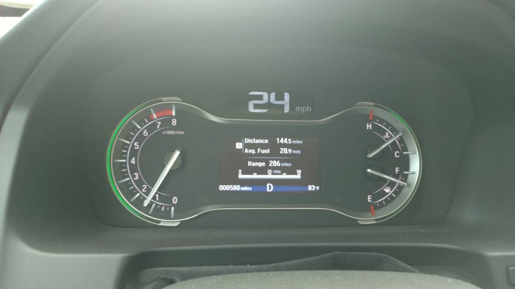

Size wise, I agree, it was in a class of its own. Mileage wise, I have yet to finish a whole tank but my 2016 Pilot easily equals what the 5 returned due a light foot and cylinder deactivation, despite AWD, +600 lbs, seating for 8 and a much bigger footprint. It surprised me frankly and although the computer seems to consistently lie based on manual calculations, the 1.5 mpg "optimistic discrepancy" still gives me a good return all things considered.
