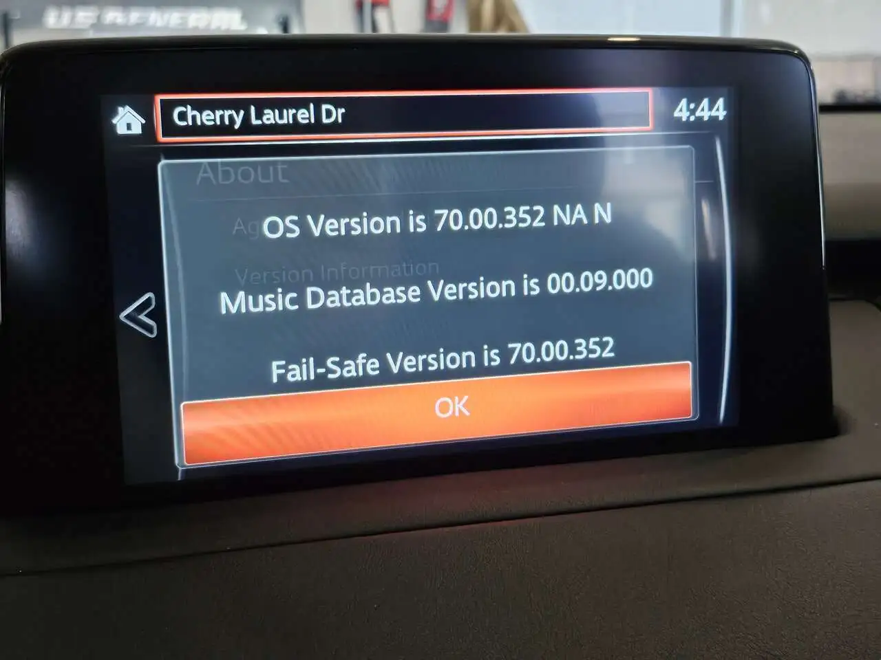

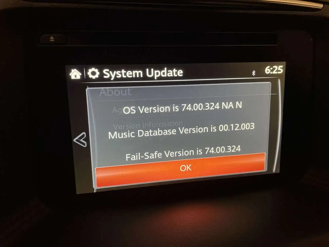

1. Go to touchscreen red 'SETTINGS',
2. Side Scroll to Top Far Right Folder 'SYSTEM',
Scroll Down to 'ABOUT'
3. Touch 'Version Information'.
FULL Version Numbers and Region Letters are revealed,
Next ONLY send a Picture of this screen details.
Also tell me in what country is your Mazda driven in.
Hi,
I have a Mazda CX-9, in US 2020
OS ver 70.00.335 NA N
Music Database 00.09.000
Fail-Safe 70.00.335
Do I need any updates?
Thank you so much!
